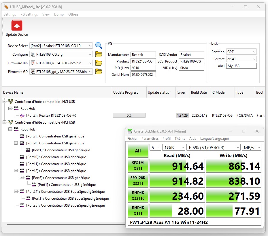

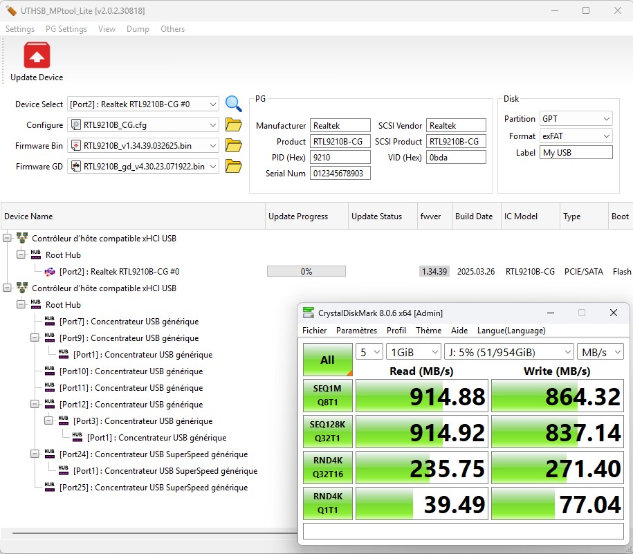

Realtek RTL9210(B) NVMe/USB 3.1 Controller firmware Version 1.34.39.032625
Please feel free to provide feedback on this new firmware.
