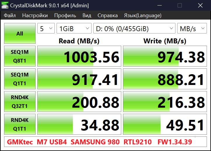

SABRENT EC-SNVE newly bought from Amazon.com shipped/delivered on July 28, 2025. Stamped code 2509 which is probably Year 2025 Week 9 (February 23, 2025-March 1, 2025)
Stock Firmware v1.33.44.011824 (August 27, 2024)/v4.30.23.071922(GD)
Firmware v1.33.44.011824 (August 27, 2024)/v4.30.23.071922(GD)/UTHSB_MPtool_Lite_v1.15.8.0119 provided by SABRENT Technical Support
Download at:
download.ru/files/6FLKjNHh
Dump
Successfully updated to firmware v1.34.39.032625
Question for @admin, what is the difference between these two firmware(s) v1.34.39.032625?
