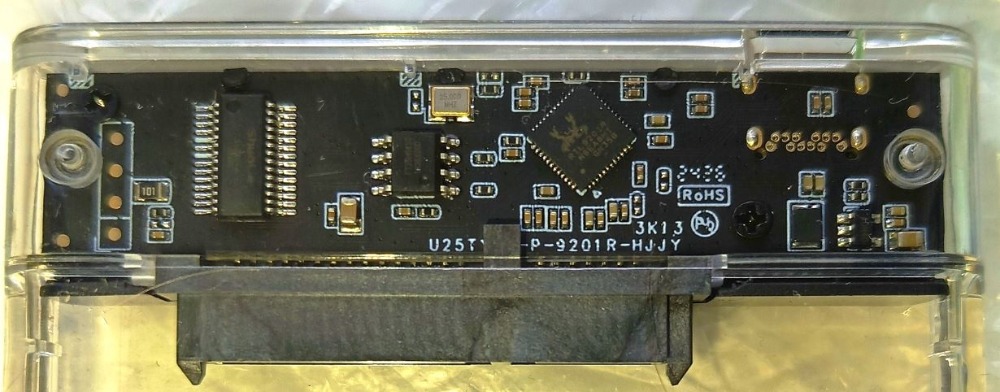

I did not unsolder the chip. First I made one dump of the box with a color screen with NeoProgrammer, the second dump I made with AsProgrammer. Both dumps were identical. With this dump I successfully flashed the box with a monochrome screen.
NeoProgrammer identifies memory in a case with a color screen as FT25H04, in a case with a monochrome screen as ZB25WD40.
In AsProgrammer I chose N25S40 Nantronics.
Before that I broke the smart information output on the case with a monochrome screen by flashing 1.32.7 firmware.

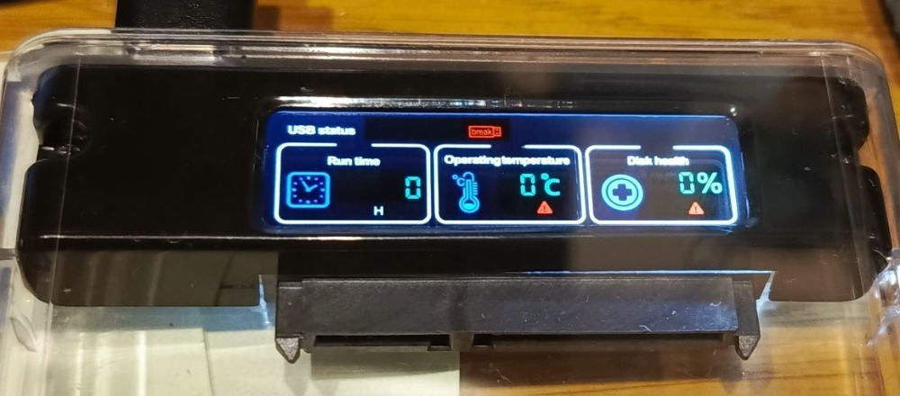

Apparently this firmware does not support the output of such information. Then I flashed your Cofre Disco Duro 1.33.88 SPI dump. This firmware is newer but does not have PERIPH_API = 0x01 in the configuration responsible for RTL9201R communication with an additional controller for display on the screen.
The original firmware in the case with a monochrome screen was 1.32.62
