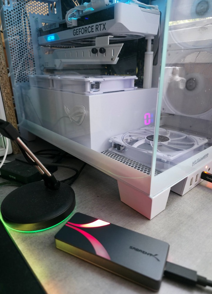

Thank you, I managed to make a part work and by changing the led line of the CFG file now the part flashes but not on the whole part, too bad
VID = 0xbda
PID = 0x9220
MANUFACTURE = "Realtek"
SCSI_VENDOR = "Realtek"
PRODUCT = "RTL9220"
SCSI_PRODUCT = "RTL9220"
SERIAL = "012345678918"
DISK_IPS_THRES = 1
LED = 0x3
;HW_LED_CFG = 0x0
CUSTOMIZED_LED = 42 00 02 00 00 00 00 00 00 00 00 00 00 00 00
;SUSPEND_LED_OFF = 0x0
UART_DBG_PIN = 100
PERIPH_API = 1
UART_BAUD_RATE = 57600
SUSPEND_DISK_OFF = 0x7
SCSI_WP_PIN = 0xb
