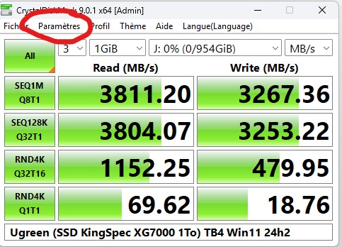

il y a 1 an 3 mois - il y a 1 an 3 moisThis allows you to know if the disks are compatible with the ASM2464 chipset and the latest firmware
with SSD option in settings
