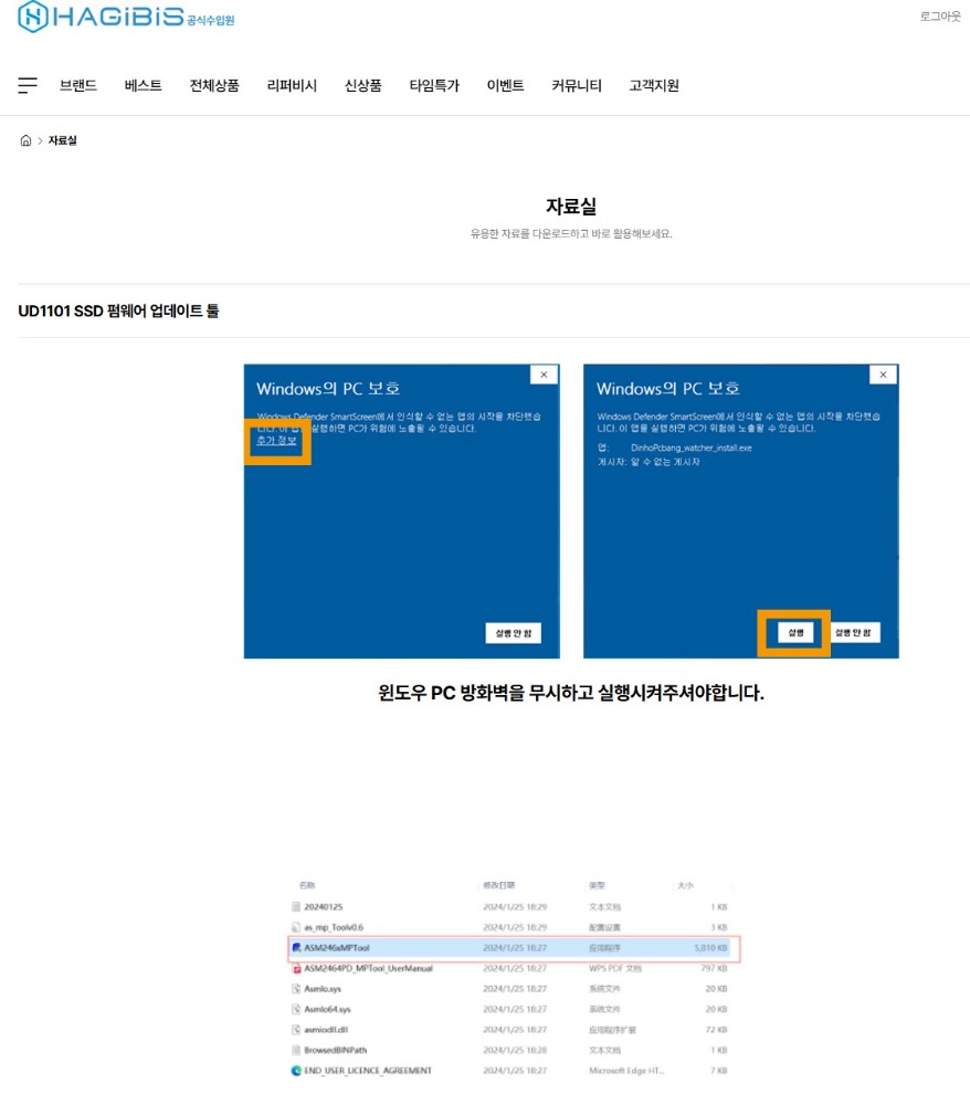

i mainly wanted it as i have been trying to get firmware out of hagibis for around a year its like pulling teeth
i will watch the korea website super annoying that i had to make a naver account to download though
