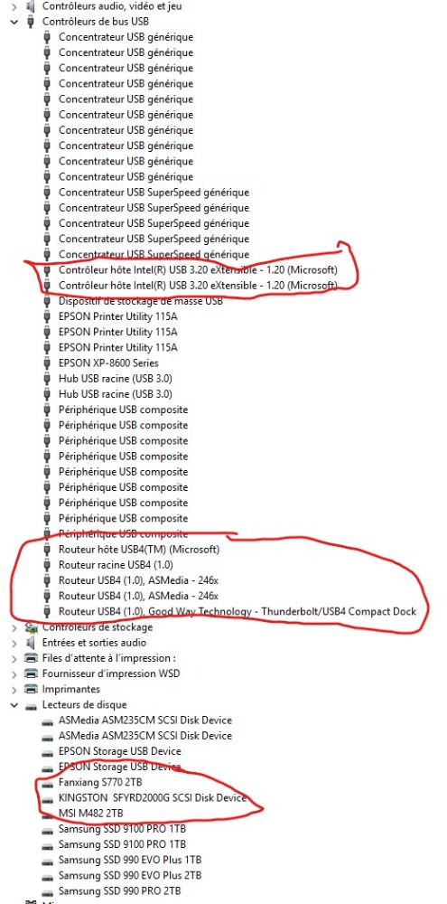

If you want to maximize performance, always plug into a USB-C port (3.2 x 2 speed 20Gbps).
I have three SSD enclosures (2 x 40Gbps & 1 x 20Gbps).
