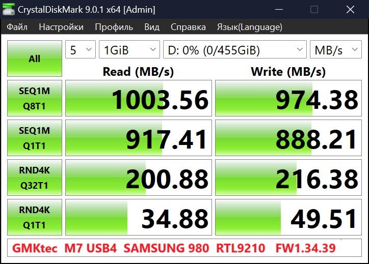

il y a 1 an 1 moisTake the number(s) from the following table and divide by 8 to get the MB/sec so 5000 divided by 8 is 625.Hi. Thanks for answering. But 5gbps is not about 625mb/s? I use cable 3.0 and in first time show me my 625mb/s speed but after speed down.
I use asus x415ea.
1x USB 3.2 Gen 1 Type-A (data speed up to 5Gbps)
1x USB 3.2 Gen 1 Type-C (data speed up to 5Gbps)

As far as speed is concerned, right clicking on properties and then the removal policy and changing it to "Better performance" and then enable write cachinng should give maximum performance:
