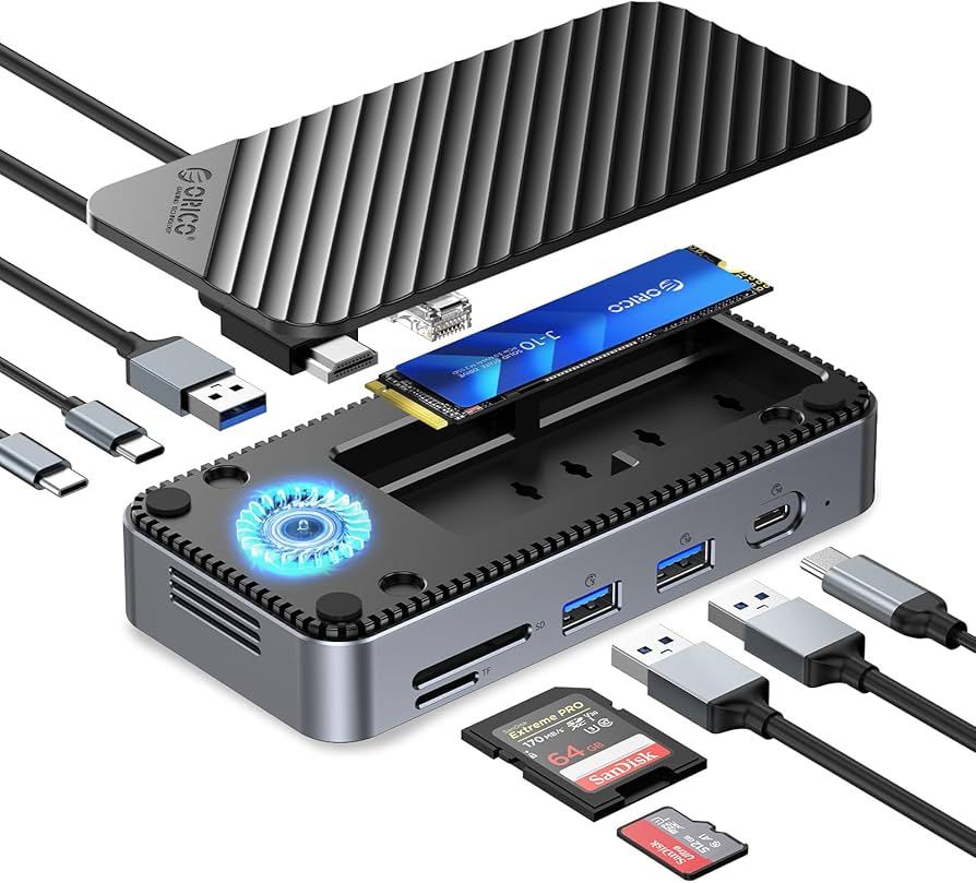

il y a 1 an 6 mois - il y a 1 an 6 moisI have an ORICO-DPM2P9-V1 docking station. While updating the firmware, I forgot to back up the original configuration. Now the device gets very hot and the fan is constantly running at high speed. If anyone who owns this device could kindly provide the original configuration file, I would be extremely grateful.
Any help would be greatly appreciated!

Hi, have you tried several Config Files (*.cfg) for the package(s) that integrate the firmware?
Furthermore, the box has several functions that need to be checked to see if everything is working as well.

Try contacting Orico to see if you can get them firmware from them,I now at one time they were pretty good about supplying firmware.
