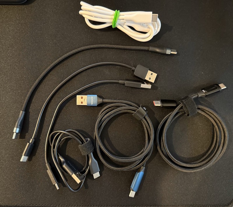

No, all the enclosures work at the correct speeds now with the right cable.

After receiving my new enclosures (JMS583) today, and they also ran at USB 2.0 speeds, I was able to figure out the problem.
Of the cables in the photo, guess which one(s) support speeds of USB 3+? ............................... None of them!
I had another two cables--one really bent and twisted one that came with the new enclosure, and another really short and thick one. These connected the new enclosures AS WELL AS MY ORICO ENCLOSURE at the correct speeds, reported as: USB 3.2 Gen 2 SuperSpeedPlus.
I hope this helps someone in the future, and thanks to those who assisted.
