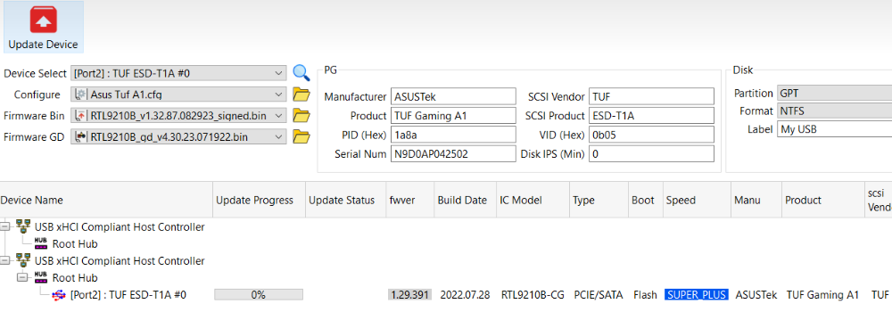

Thanks you as well,
So to clarify, I should edit my dump file as following:

like this right? and save it like dump.cfg and select dump.cfg as a configure in mptool?
so if it like this, it's not gonna break my a1 during update right?
also if it does have problem how can I revert it back without using the pin 1 and 8 technique?

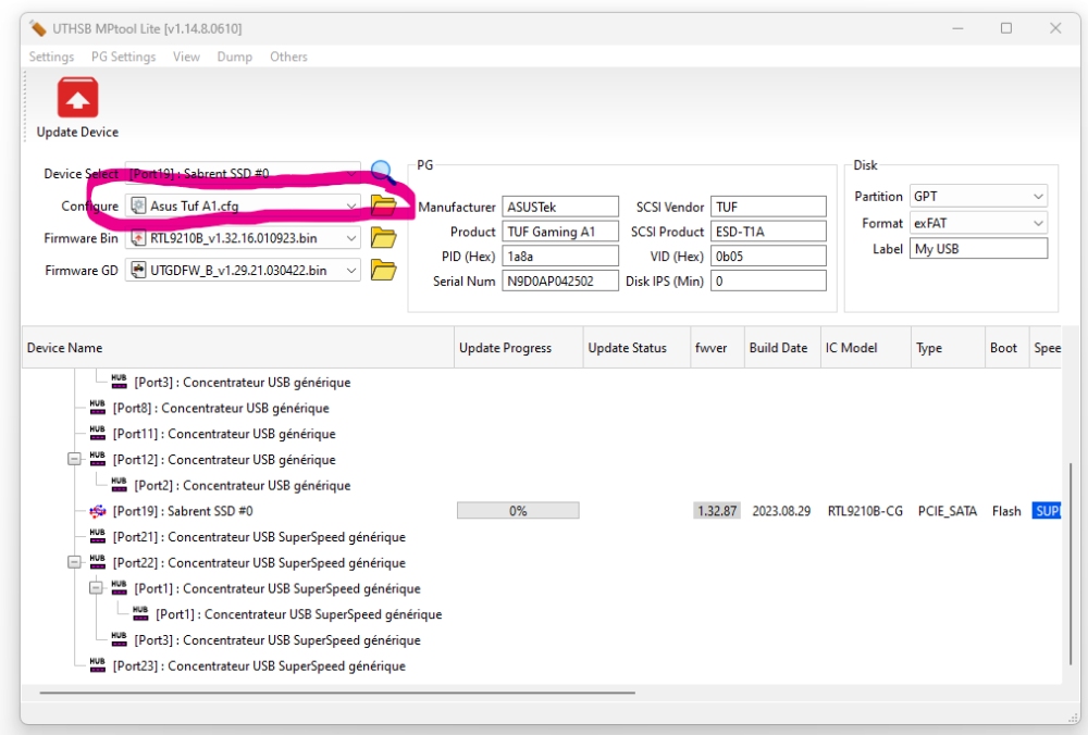

Ok take the firmware pack then the configuration file and select it in the update utility as below
Firmware Realtek RTL9210
Fils Config Asus A1
Fils Config Asus A1
