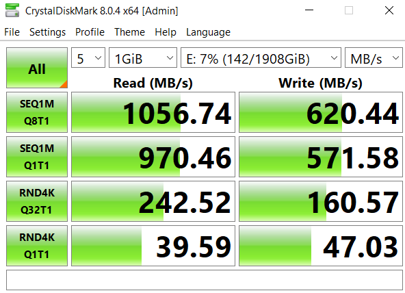

Hello
I just bought the asus tuf gaming a1, and I heard all that use realtek 9210b chipset should update it firmware, I search online and the tools seem to be from here.
I don't want to broke my tuf a1 so here I ask, how to update fw without breaking it. I read that if there is problem with the update, with dump info then I would know what the original parameter are, but how to revert the update with that dump info I save before perform an update?
If any one here can provide me step about what to do and answer me how to prevent it from brick that would be a lot of help (I read here there a bridge 1 and 8 pin to reset? but I'm not confidence enough to do that)

the reason I want to update my tuf a1 is because the writing speed, reading speed is as what the spec was, but the writing speed is not.

- Absent
il y a 2 ans 10 mois
Hi, you can update it without any problem, you just need to retrieve the configuration file to use it for the update
