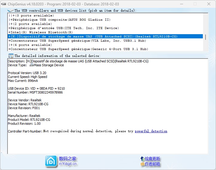

3.2 Gen1 is 5Gbit, some mainboard makers go cheap and wire Type-C ports to 5Gbit for cost cutting. A nice example are those
cheap
A620
Chipsets which have the option for 10Gbit both from CPU and Chipset.

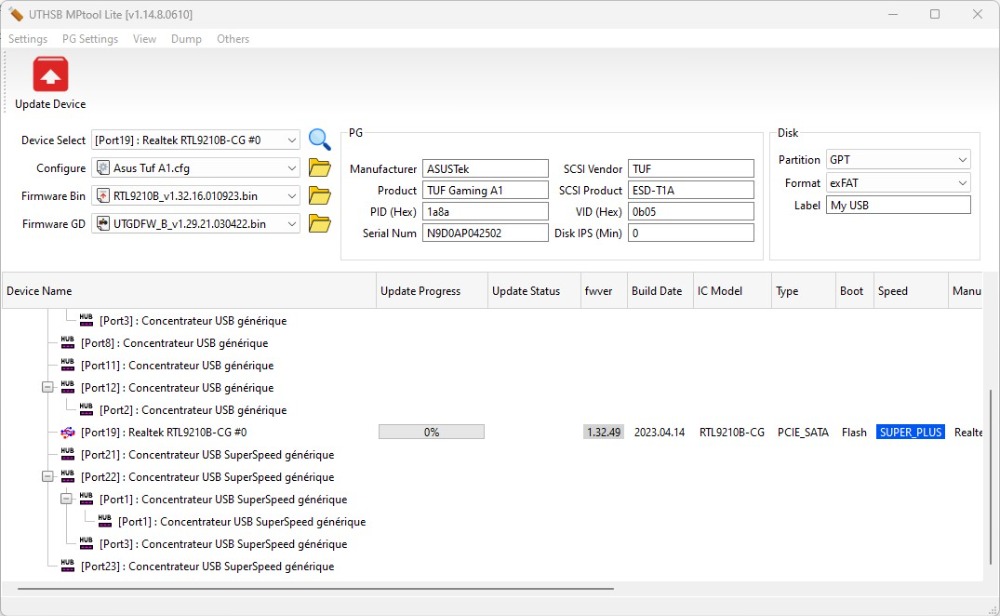

to be sure to be in USB 3.2, check with the Chipgenius utility below

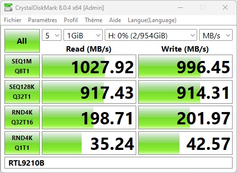

the 500 Mbps instead of 1000Mbps and a speed problem due to the port or the cable as said by Alien Invader
The firmware can also but already check the port then the cable (USB-C port)
or via the update utility (Super plus)
