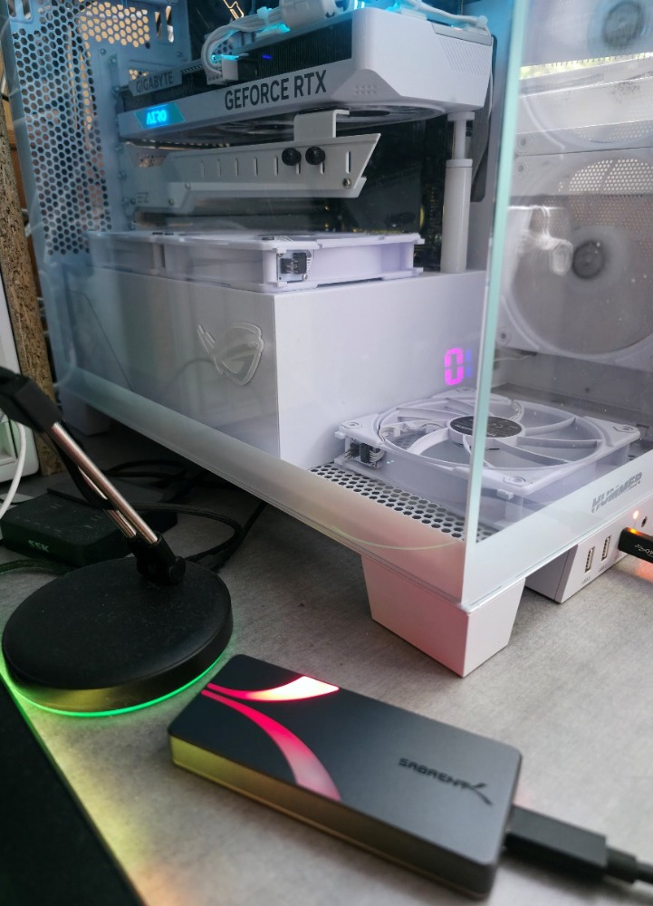

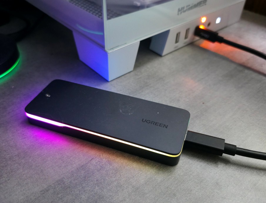

Thank you, I managed to make a part work and by changing the led line of the CFG file now the part flashes but not on the whole part, too bad
VID = 0xbda
PID = 0x9220
MANUFACTURE = "Realtek"
SCSI_VENDOR = "Realtek"
PRODUCT = "RTL9220"
SCSI_PRODUCT = "RTL9220"
SERIAL = "[url=tel:012345678918]012345678918[/url]"
DISK_IPS_THRES = 1
LED = 0x3
;HW_LED_CFG = 0x0
CUSTOMIZED_LED = [url=tel:42 00 02 00 00 00 00]42 00 02 00 00 00 00[/url] [url=tel:00 00 00 00 00 00 00]00 00 00 00 00 00 00[/url] 00
;SUSPEND_LED_OFF = 0x0
UART_DBG_PIN = 100
PERIPH_API = 1
UART_BAUD_RATE = 57600
SUSPEND_DISK_OFF = 0x7
SCSI_WP_PIN = 0xb
Despite the change in the CFG file, this does not allow total lighting but only on one side.

Did you use version 1.32.82 and light only has one side?
The right led bin file I think we need to wait from ugreen.
I have a Ugreen RGB box but how do I retrieve the LEd bin file?
Yes, only on the right side they hope for a firmware
