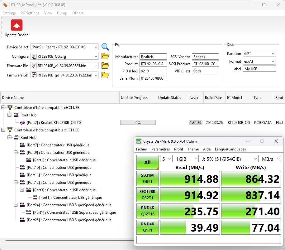

Realtek RTL9210(B) NVMe/USB 3.1 Controller firmware Version 1.34.39.032625
Please feel free to provide feedback on this new firmware.
Download www.station-drivers.com/index.php/en/com...9.032625/lang,en-gb/

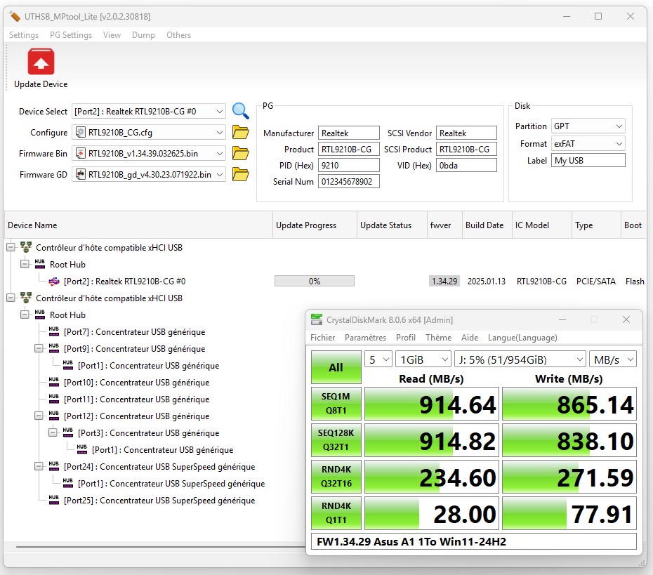

I just bought a SABRENT EC-SNVE enclosure from Amazon.com along with a Samsung 990 Pro 4TB SSD.  This is my first time using a SSD enclosure and I have a few questions about upgrading the firmware after reading this entire thread about the configuration file.  Am I supposed to use the original configuration file or am I supposed to take the configuration file included with the new firmware and then replace the entries for things that exist in the original configuration file and keep anything else that does not exist in the original configuration file?  I still have not opened the enclosure and the SSD package yet but I will take a dump and also see what version of firmware actually shipped with the enclosure.  Is 1.34.39.032625 the latest firmware available and has anyone with a SABRENT EC-SNVE actually used 1.34.39.032625 with it and are there any issue(s) I should be aware of?  Thanks!

Follow the instructions here for configuration
station-drivers.com/index.php/en/forum/e...-1-xx?start=265#2012
1.34.39.032625 is the latest version
