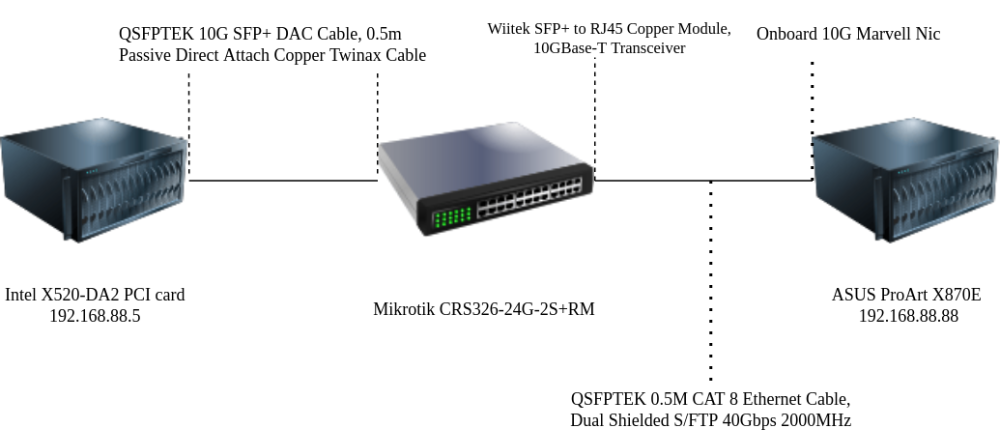

My topology is like this:

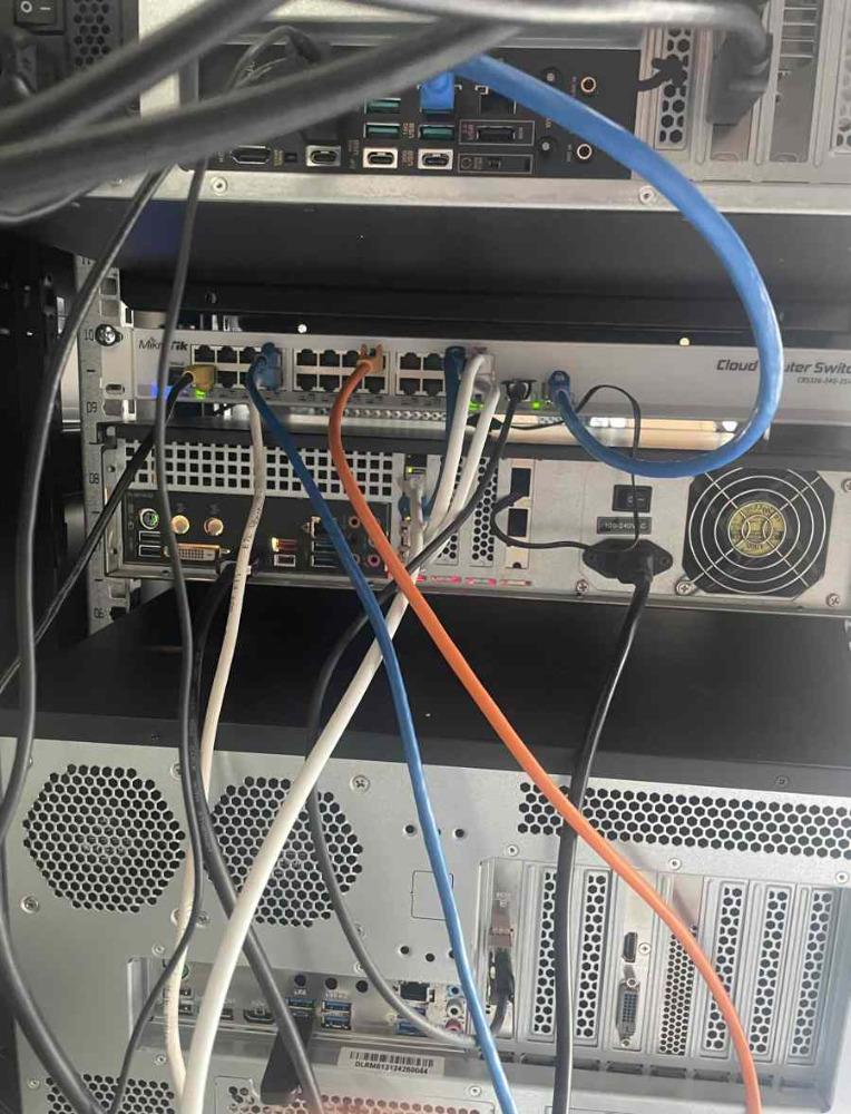

Here's a picture of my rack, from behind. (The (blue) CAT8 cable from the AQC113CS interface to the SFP+ module is not in contact with any other cables)

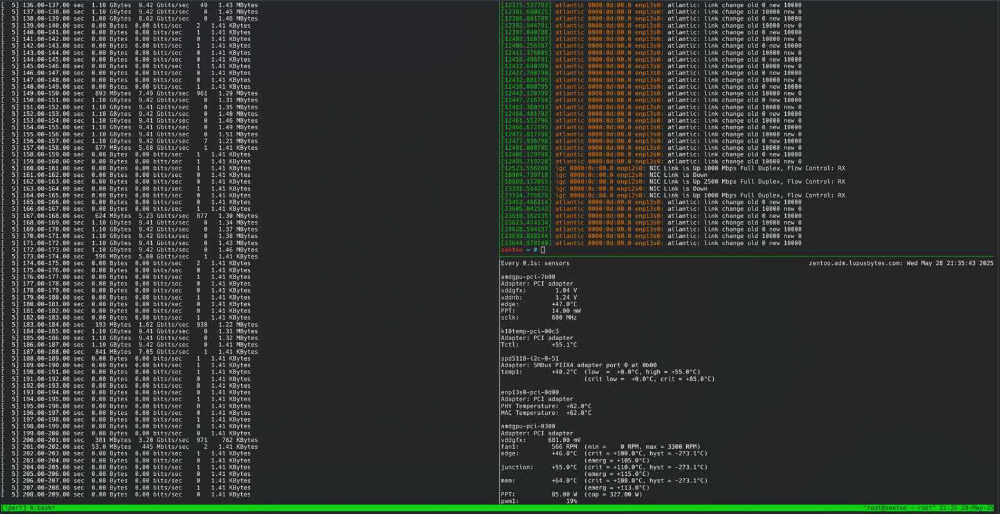

Here's a screenshot of a iperf test i did.
full resolution: imgur.com/a/x0ch49B
After 2 minutes it starts disconnecting the interface. (Same thing happens on Windows with the newest drivers).
You should only pay attention to the last 6 lines of output of dmesg in the upper right corner.
The other entries are old and is me swapping cables around and not related to the test.
It keeps flapping up and down between 10Gigabit and 0.
We can also see on the network interface sensor that it is running at 62C when it starts dropping.
This is the highest temperature I've ever seen it go.

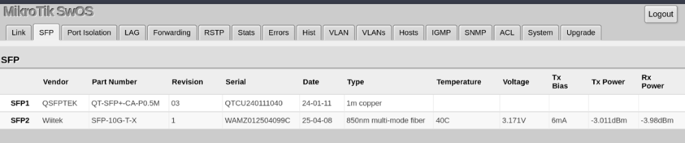

On the switch side I only have 40C on the SFP+ module and 38C on the CPU. (I have added case fans to the switch which helps tremendously for this model)
I don't think the temperature on either side is the problem.
When using the Intel 2.5G NIC with the same cables and SFP+ module, I can run iperf tests indefinitely and not have any packet loss.
