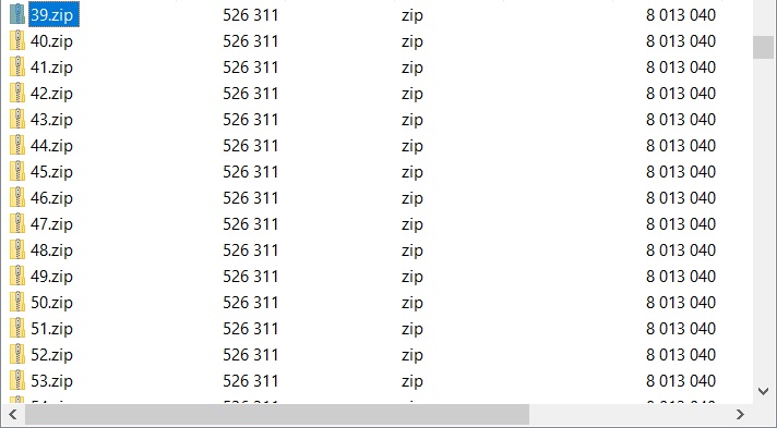

7-Zip and Resource Hacker also do not reveal the embedded INF/CAT files.
With 7-Zip, right-click SetupChipset.exe, choose Open archive > #:e
When 7-Zip open, scroll down and locate several zip files, choose someone (i.e. attachment) and you can view and extract inf/cat files inside Drivers folder.
