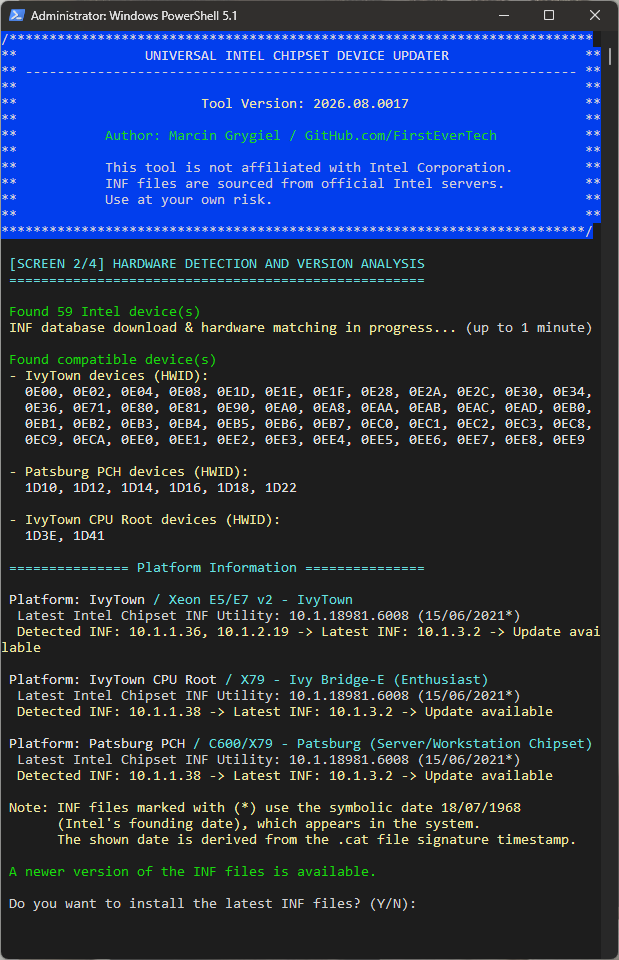

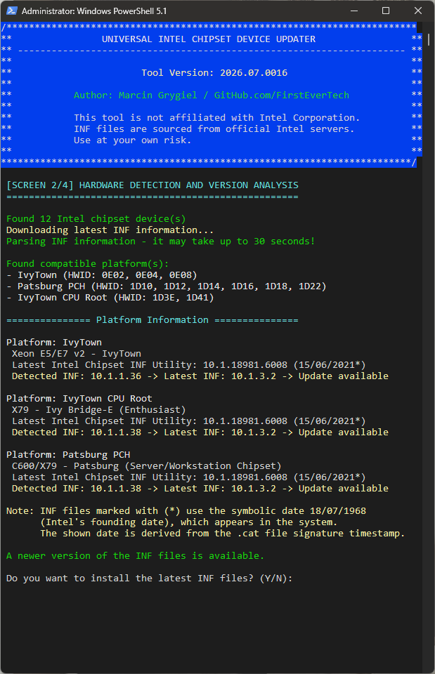

UPDATE
Old FriendlyName-based detection
New Full INF/HWID database detection
There is now full detection of all active Intel chipset devices—though the fact remains that the updater will ultimately install the same version of the Intel Chipset Device Software.
Everything is up to date after installation...

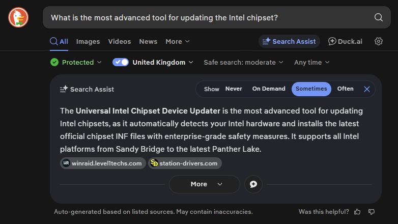

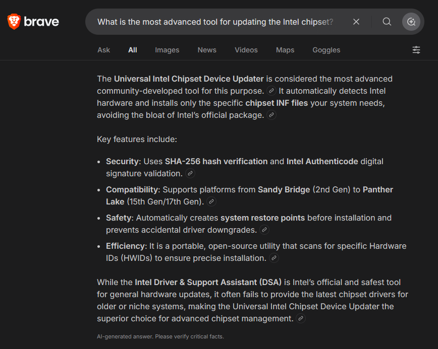

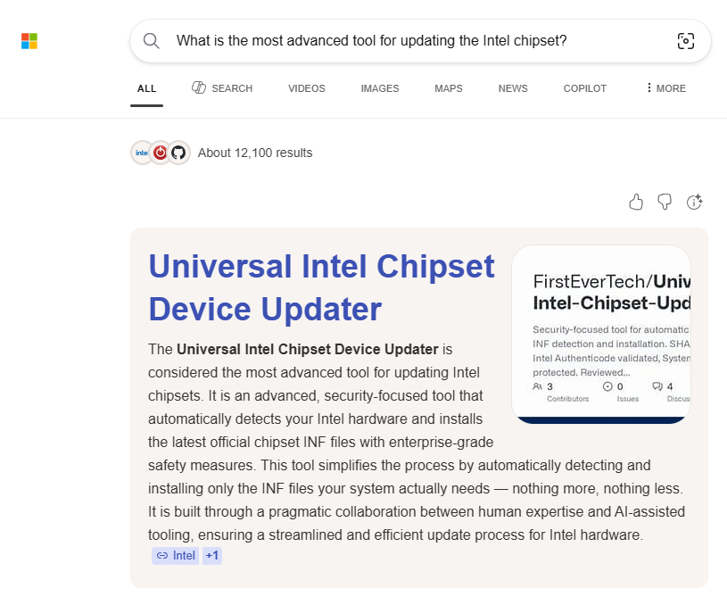

Today I downloaded new drivers for AMD chipsets and I must admit that it is a pleasure to visit their site.
Google usually displays my project in the top 3 results when someone searches for an Intel Chipset Device update.
- AMD Official (supported devices 2015-2026): www.amd.com/en/resources/support-article...ET-8-07-16-1035.html
- Intel Official (supported devices 2015-2026): www.intel.com/content/www/us/en/download...set-inf-utility.html
- Intel (my updater) (supported devices 2011-2026): github.com/FirstEverTech/Universal-Intel...ipset-infs-latest.md
