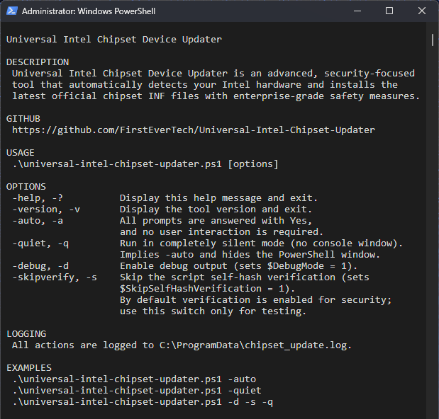

Heads-up for Admins: Upcoming Update with Admin-Friendly Features
I'm happy to announce that tomorrow I'll be releasing a new version of the Universal Intel Chipset Device Updater
with several enhancements specifically designed for administrators and automated deployments.
What's new?
The script will now include dedicated command-line options. These allow for fully unattended execution, silent operation,
and fine-grained control – perfect for integrating into MDM solutions like Microsoft Intune, SCCM, Workspace ONE, or PDQ Deploy.
Key improvement:
The PowerShell script (.ps1) can now be used completely independently – no more need for the batch wrapper (Run.bat).
Of course, if you're already using the .bat file, it will continue to work without any issues; the script is fully backward compatible.
Why this matters for admins:
By using the .ps1 directly, you avoid the common pitfalls associated with self-extracting executables (SFX) – no more concerns
about unsigned code, local certificate warnings, or antivirus false positives. The script is just plain text, easily reviewable,
and can be executed with your preferred execution policy settings.
Once the new version is live, you'll be able to grab it from the usual place (GitHub) and soon also from the PowerShell Gallery.
Stay tuned!
What's new?
Key improvement:
Stay tuned!

Manual update (for v2026.03.0012 or older)Install-Script universal-intel-chipset-device-updater
Run PowerShell as Administrator:
Launch the updaterUpdate-Script -Name universal-intel-chipset-device-updater
Options:universal-intel-chipset-device-updater
-help, -? | Display help and exit.
-version, -v | Display the tool version and exit.
-auto, -a | Automatically answer all prompts with Yes — no user interaction required.
-quiet, -q | Run in completely silent mode (no console window). Implies `-auto` and hides the PowerShell window.
-beta | Use beta database for new hardware testing (available from version 2026.03.0013).
-debug, -d | Enable debug output.
-skipverify, -s | Skip the script self-hash verification. Use only for testing!

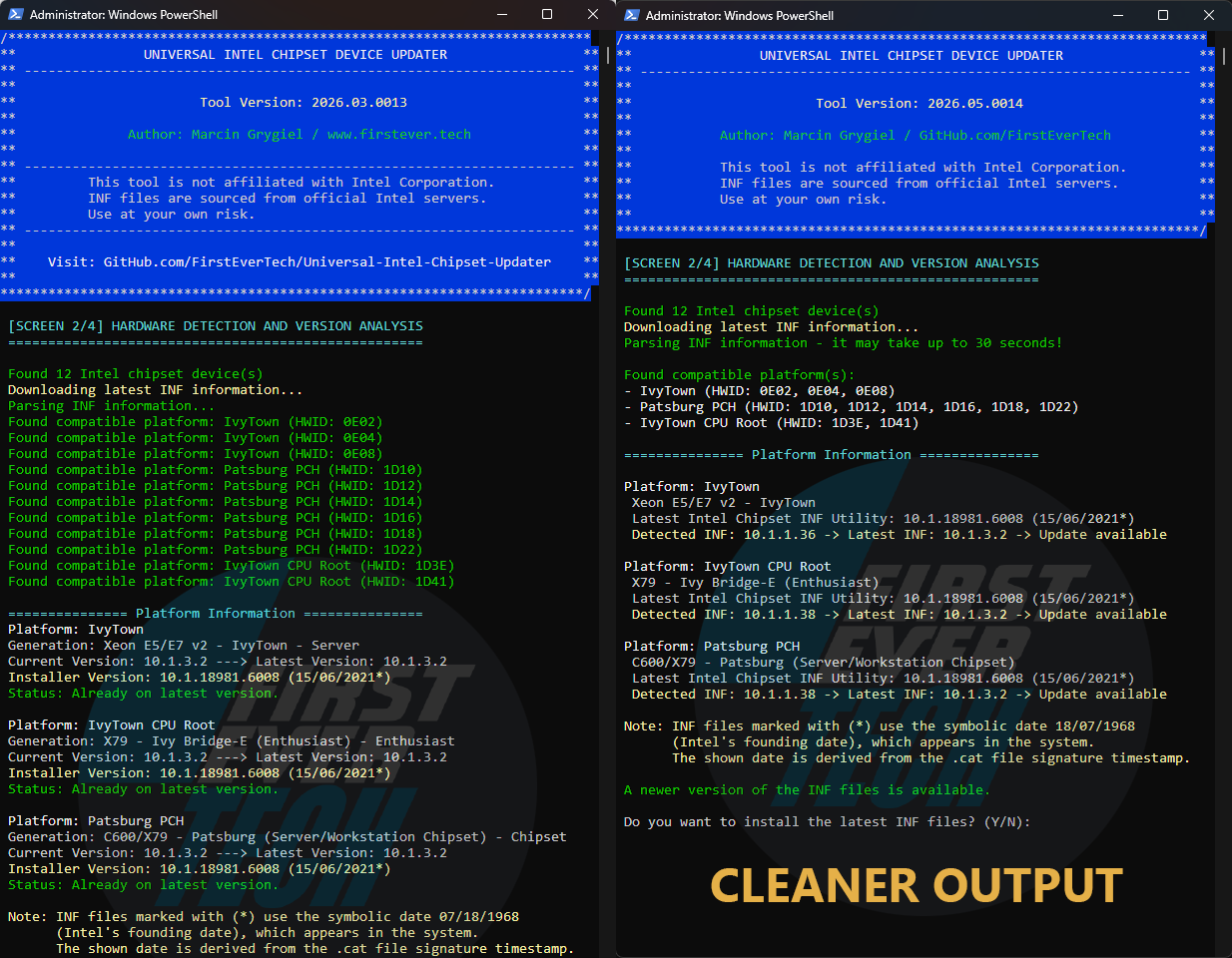

Release: v2026.05.0014
🆕 What's New
Intel Platform Scanner 7.1 (Database Generation)
The scanner script (Intel-Platform-Scanner.ps1) has been significantly improved to produce a cleaner, more accurate intel-chipset-infs-latest.md database:
🆕 What's New
- Fixed ArrowLake generation – now correctly shows 15th Gen Core/Core Ultra 200 (was 14th Gen)
- Added missing generic platforms – ArrowLake, RaptorLake, AlderLake, TigerLake, CometLake, IceLake, Lakefield, CoffeeLake, KabyLake, Skylake, Crystalwell now have proper Order values and appear in correct chronological order
- PCH Family sorting – all PCH entries (including LynxPoint, PantherPoint, CougarPoint, Wellsburg, Patsburg, Lewisburg, Emmitsburg, etc.) now follow a consistent newest-to-oldest order
- MeteorLake PCH moved – MeteorLake PCH-N/H/S relocated from CLIENT - Core to PCH Family (correct logical category)
- DmaSec extensions – six *_Extension-Dmasec entries moved to PCH Family with proper generation descriptions
- IceLakeX reclassified – moved from XEON / SERVER to WORKSTATION / HEDT
- Legend cleanup – platforms without dedicated INF files (e.g., Emerald Rapids, Ice Lake-SP, Cascade Lake-X) now have a * and an explanatory note in the footer
- New notes in MD footer:
- Wildcat Lake shares HWIDs with Panther Lake
- Panther Lake H/U are merged into a single entry (same INF)
- 16th generation (Lunar Lake) is classified under ATOM / LOW POWER
- Platforms marked with * have no dedicated INF (handled by adjacent INF or inbox drivers)
- Fixed duplicate type suffix – Generation field no longer ends with redundant - Desktop/Mobile
- Grouped HWID display – instead of one line per device, platforms are shown with their HWID list (e.g., - IvyTown (HWID: 0E02, 0E04, 0E08))
- Compact platform information– each platform uses only 3 lines:
- Platform name (white)
- Generation text (gray) – without the word Generation: (prevents long names from wrapping)
- Latest Intel Chipset INF Utility (gray)
- Detected → Latest → Status (colored: green/yellow/magenta)
- Parsing hint – Parsing INF information - it may take up to 30 seconds! (replaces the old ambiguous …)
- Simplified header banner – removed redundant separator lines and the Visit: row; author line now includes GitHub link
- Better Windows Inbox handling – inbox platforms are shown in a compact grouped list, not interleaved with regular updates
- Extra blank lines removed – no more double empty lines before the platform information section
