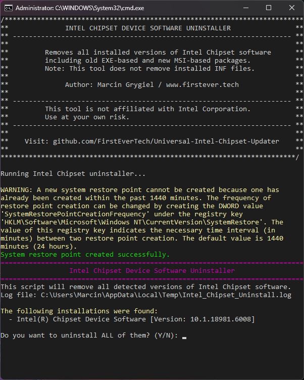

About uninstall-intel-chipset.bat
You wrote: "it seems overly complicated, even if I could get it to work."
Could you clarify – did you actually run the uninstall tool, or not?
Its logic is very straightforward:
The uninstall tool is meant to remove only the installer entry, not the already installed INF files.
- It scans the Windows registry (uninstall keys) for entries containing
"Intel(R) Chipset Device Software" (old Intel installers) or "SetupChipset" (newer MSI‑based installers). - For each found entry it extracts the uninstall command – whether it’s an .exe uninstaller or an msiexec product code.
- If the original installer files have been deleted, it simply cleans up the leftover registry keys so they no longer block future installations.
What I’d like to know
- Did the uninstall tool detect any installed versions of "Intel Chipset Device Software" on your (internal) Windows system?
- If yes, did it show you the version and then successfully remove it?
- Download and reinstall the exact version that was detected (if you can't find an installer, I can provide one).
- Use the installer’s own repair/modify option (or simply run it again to trigger a reinstall).
- Then uninstall it properly – a reinstall/repair often fixes a broken installation state.

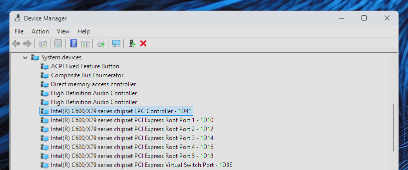

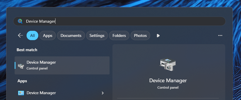

- Open Device Manager (one of the following)
- Press Win key + X → Device Manager
- Press Win key → type: Device Manager
- Press Win key + R → type: devmgmt.msc
- Find an Intel chipset device
Expand the "System devices" section. Look for any entry with "Intel", "Chipset", "LPC", etc. in its name.
Often the name already contains the Hardware ID – for example:- "Intel(R) C600/X79 series chipset LPC Controller – 1D41"
Here the HWID is 1D41.

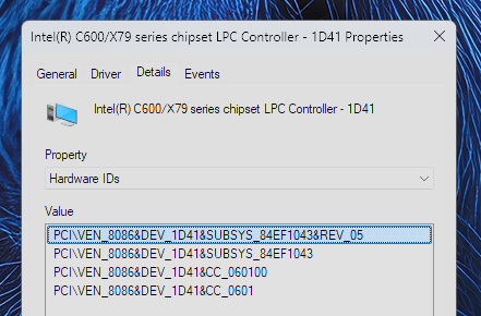

- If the HWID is not in the name, check the Hardware IDs property:
- Right‑click the device → Properties → Details tab → Property dropdown → select "Hardware Ids".
You will see something like: - PCI\VEN_8086&DEV_1D41&CC_0601
The part after DEV_ (here 1D41) is the device ID.

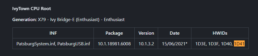

- Look up the HWID in the database I maintain on GitHub
Open my latest INF database in your browser: intel-chipset-infs-latest.md
Press Ctrl+F and search for that HWID (e.g. 1D41).
Note: If your device is not treated as a chipset component, or if it is a chipset device that Intel never included in any of its Chipset Device Software packages (i.e., the INF comes from Windows Inbox Drivers), the HWID may not appear in this database.
You will immediately see:- The latest INF version for that device,
- Which (latest) Intel Chipset Device Software package contains it,
- The date shown is taken from the digital signature timestamp of the associated .cat file (the catalog file that signs the INF files), so it accurately reflects when the package was released, even if the INF itself contains a dummy date like 1968/1970 – this happens because Intel no longer embeds dates in newer INF files.

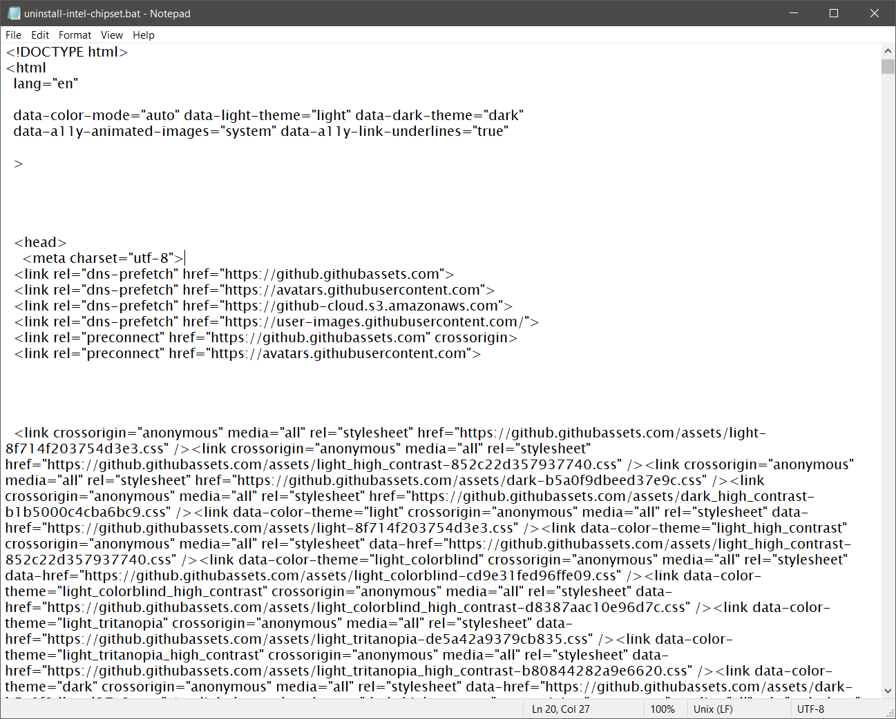

1. Tried R-clicking "uninstall-intel-chipset.bat" & "run as admin": nothing happens
2. Tried navigating to that file location at a "run as admin":command prompt window: output "the syntax of the command is incorrect".& "!DOCTYPE html".

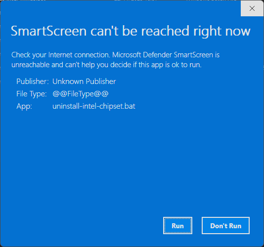

The only thing that popped up after I disconnected from the internet was an additional SmartScreen window.
After clicking "Run", it starts normally.
It's possible your antivirus is the problem...

The `!DOCTYPE html` error means you downloaded a GitHub webpage instead of the raw script files.
Please do the following:
1. Delete the old .bat and .ps1 files you downloaded.
2. Download them again, but correctly:
- Go to the raw version of each file on GitHub :
- uninstall-intel-chipset.bat (raw)
- uninstall-intel-chipset.ps1 (raw)
- Right‑click each link → Save link as… (do not copy-paste from the browser).
3. Save both files in the same folder.
4. Right‑click the .bat file → Run as administrator.
If nothing happens, open PowerShell as admin and run:
PowerShell: Set-ExecutionPolicy RemoteSigned -Scope CurrentUser -Force

Opening your "uninstall-intel-chipset.bat" file in Notepad results with several thousand lines of code, starting with:
What purpose for all of these web links, if they're not being used?
