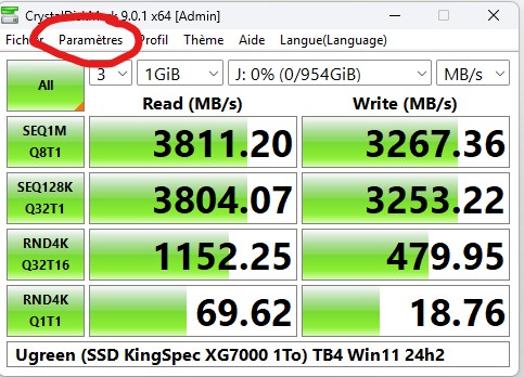

1 year 4 weeks ago - 1 year 4 weeks agoThis allows you to know if the disks are compatible with the ASM2464 chipset and the latest firmware
with SSD option in settings
