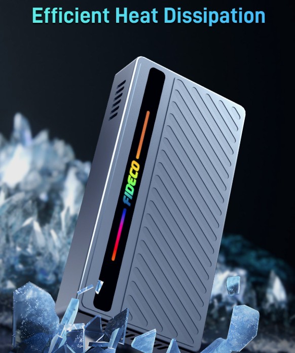

For those like me who have experienced the decorative LEDs going out, here's a utility that restored them after the update.
You need to run the utility "RN09_AutoUpdate.exe".
After the update, please configure the Mptool settings, as it's set to Thunderbolt 3/USB3.
You can also configure it to install the latest firmware and change certain parameters.
But do this after the update to ensure the LEDs are restored before making any changes.
The update restored the LEDs on my Fideco case.
