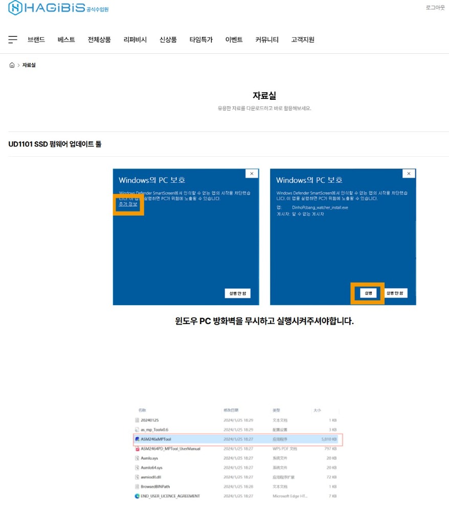

i mainly wanted it as i have been trying to get firmware out of hagibis for around a year its like pulling teeth
i will watch the korea website super annoying that i had to make a naver account to download though

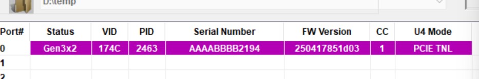

I bought QWIIZLAB Fanless USB4.
This is the native twin of the HAGiBiS MC40.
It also has a two-color connection speed indicator.
Came with firmware 250417_85_1D(29)_03
