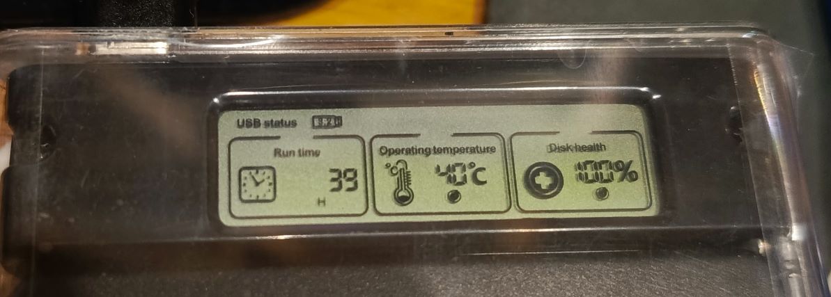

2 months 1 week agoDid you flash it to 9201R? it wont select Firmware Bin for me with a 9201R plugged inExcellent firmware. PERIPH_API for LCD is now supported. I successfully flashed the ShuoLe enclosure with BW LCD.

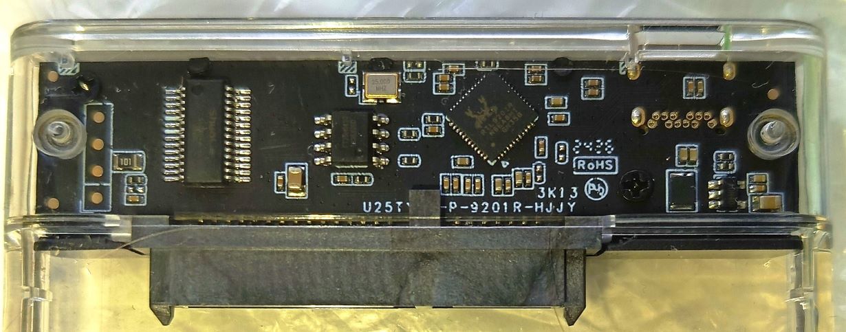

I think i know what the problem is some of my RTL9201R's have 2Mbit spi chips
this firmware is 452k so it needs 4Mbit though there's alot of FF's in the file so i may be able
to trim it down
Ok it can only trim down to 244 KB it wont flash to a 2Mbit SPI
I know a few of my pcb's have 8Mbit SPI's some 4Mbit some 2Mbit
I have checked my enclosures
Cofre Disco Duro x 5 4Mbit SPI 1.33.88 Firmware Flashable 4Mbit SPI (needs correct LCD.bin will test flashing one at some point)
UTHAI/ShuoLe U25N-L x 2 4Mbit SPI 1.34.29 Firmware Flashable 4Mbit SPI (needs correct LCD.bin)
UTHAI Q5 x 4 2Mbit SPI 1.32.7 Firmware
UTHAI Q6 x 6 2Mbit SPI 1.32.7 Firmware
UTHAI Q7 x 7 2Mbit SPI 1.32.7 Firmware
to trim it down

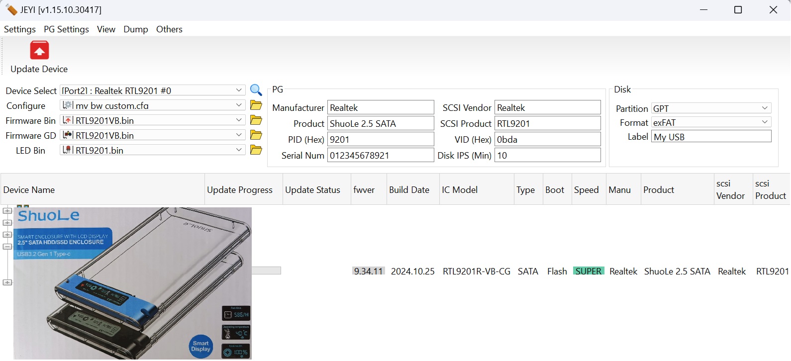

Here's a copy of all i have for the RTL9201
MPtool_Lite v2.0.20.50509
MPtool_Lite_Mini v2.0.4.31218
Its setup out of the box to flash a Cofre Disco Duro
With 9.34.11 + UTHAI LED as its slightly nicer looking
and has Configs for UTHAI U25N-L but i dont use it as that Enclosure
came with a newer factory firmware so i just edited its SPI
Firmwares Included
1.32.7
9.34.11
LED Bins Included (With CUSTOMIZED_LED code in file name to be inserted into the ini)
If your enclosure led's are rgb you should be able to use any of these with the correct CUSTOMIZED_LED code inserted into the ini
if your led is not rgb you will just get no light until you flash with no led.bin and set the correct CUSTOMIZED_LED = 00 08 for example of a non RGB led
Cofre Disco Duro 9.32.74_LED_41_00
Cofre Disco Duro 1.33.88_LED_41_00
JEYI RTL9201 2280 LED_sleep_green_35_02_01
UTHAI U25N-L_LED_41_02
if your enclosure doesnt use a LED.bin e.g. CUSTOMIZED_LED = 08 00
make sure to untick flash LED BIN in View,File Select
and use the correct config with correct CUSTOMIZED_LED = whatever your device uses
It has the following Factory SPI Dumps for use with a CH341
Orico 25PW1 C3 1.32.7
ShuoLe LCD 1.33.3
UTHAI U25N-L 1.34.29
mega.nz/file/huoVQTxD#kOSLFNs_bPo2wcrrw_...QDM4avs_I2NwUAjVdt1I
oh something of note i have noticed
9.xx.xx firmware is debug enabled firmware (1.xx.xx with debug enabled in the firmware)
1.xx.xx is standard release
Burst Rate in say HD Tune Pro for example is alot slower on 9.xx.xx firmwares i have noticed this on 9.xx.xx firmware on RTL9201's RTL9210B's and RTL9220's
