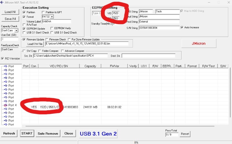

However with the 562 he goes wrong. as for the 583 the program you sent me from those errors because in the .ini file there is the path of your profile
Re: JMS583 chip
4 years 2 weeks ago - 4 years 2 weeks ago
Yes it's true I don't understand why it displays a bug otherwise I have two boxes 1st in JMS583 & 2nd in JMS578
normally if you run firmware 2.1.2
Here is the firmware 2.1.2 in automatic
JMS583 Firmware Version 2.1.2

OK thanks. It seems to work, even when I safely remove the led on the enclosure turns off correctly. We hope everything works :)
So Sabrent uses this JMS583 chip?
Last edit: 4 years 2 weeks ago by Max88.
Re: JMS583 chip
yes several manufacturers use it and for me it is the latest firmware
you can change ID if you want to put it back in JMS583, it has to reflash in this case
