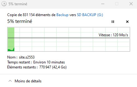

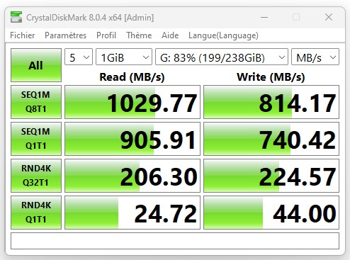

I did a test with my USB 3.1 nvme box on an Intel USB 3.2 port here are the results
some chipsets do not really like copying small files because too much calculation and the speed drops
