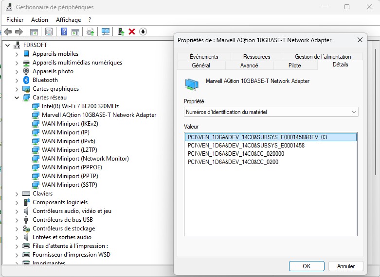

Thank you very much, I managed to boot from the USB with the suggested ISO, but unfortunately, as I run the updater, the PowerShell tries to get the ID, then closes.
No way to update my MSI Z790 Godlike Max Aquantia LAN.
Try installing the drivers because otherwise it may not detect the AQC113 chipset

Thank you, but it still doesn't work. The adapter is recognizer (a little older driver, but it from Marvell), running from HDD and not USB key as administrator, no difference.
Perhaps the ID is not recognized.
Could you take a screenshot and post it here?
It's possible the ID isn't correct.
