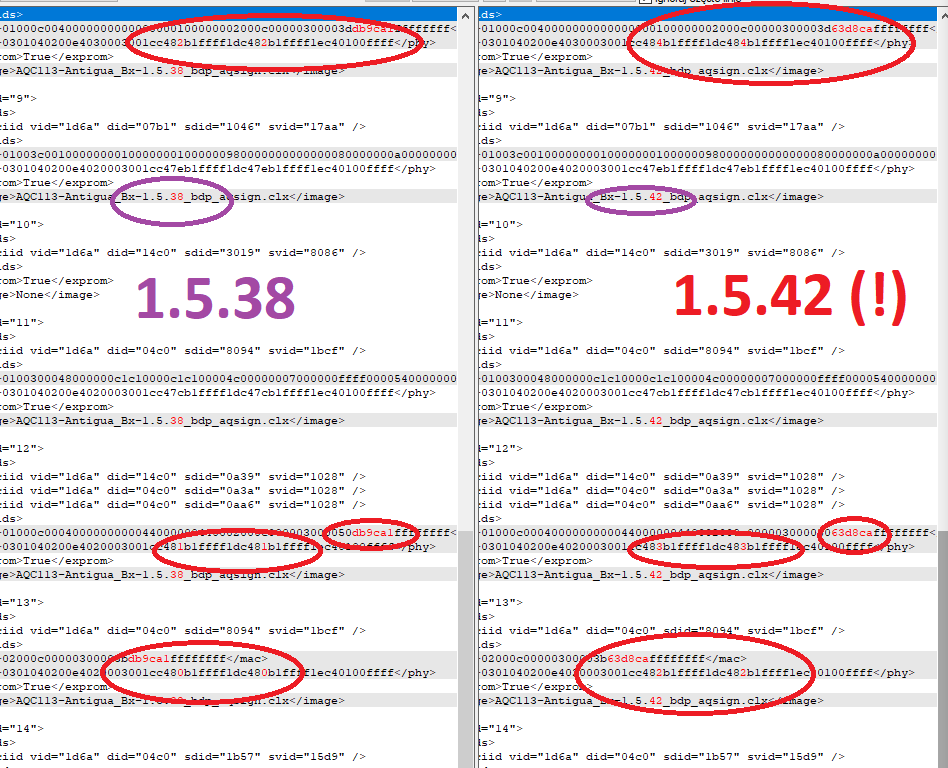

Hi,
I have to warn you about this firmware!
VERSION 1.5.42 IS COMPATIABLE ONLY WITH THE LATEST REVISION OF THE CARDS WITH AQUANTIA AQC113...
IT IS ALSO POSSIBLE THAT THIS FIRMWARE VERSION IS INTENDED TO USE IN PARTICULAR DEVICE ONLY!
This version bricks majority devices. There should be a warning on a download site.
This is also why someone ask for help on the forum, after bricking his card by flashing this version.
@admin confirms working on the X670 Proart motherboard. For now, DO NOT flash any another device unless someone would confirm the proper working. Maybe this version is only for new devices with the latest revision of the hardware.
All firmwares for AQC113 has specific values for every different device. These values are idenctical for every firmware version. They prepare PHY and MAC regions for proper working. The flashing tool uses them to authenticate/signing and build the final flash file..
The 1.5.42 version and only that version has other values for PHY and MAC regions. From my observation, those values brick all older devices at all. The Chinese (1d6a/14c0/0001/1d6a) cards as well.
All firmwares contain the same PHY and MAC values:
Only 1.5.42 version is different:
We can see that for almost all devices, MAC region has 63d8ca value instead of db9ca1 included in all previous firmwares.
In PHY we can see 2 changed bytes. All of them increase by 0x2 (0x86->0x88, 0x81->0x83, 0x85->0x87, 0x82->0x84, 0x80->0x82, 0x7F->0x81)
