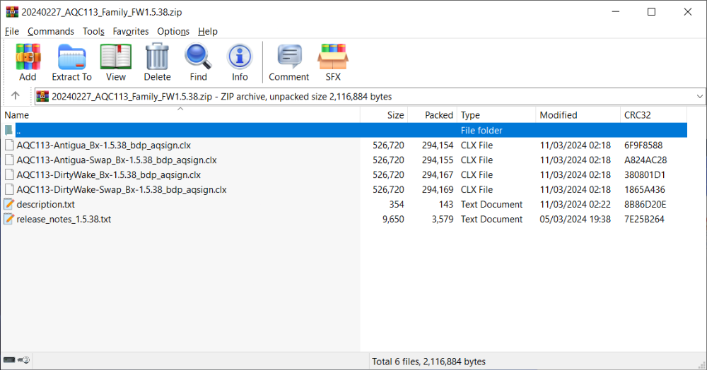

Good news i have got a reply from an oem that uses newpeak to make their card
they provided me with 20240227_AQC113_Family_FW1.5.38 there is no updatedata.xml or flasher though
AQC113-Antigua-Swap_Bx-1.5.38_bdp_aqsign.clx: There are: MDI Swap.
AQC113-Antigua_Bx-1.5.38_bdp_aqsign.clx: There are: MDI Normal.
AQC113-DirtyWake-Swap_Bx-1.5.38_bdp_aqsign.clx: There are: MDI Swap, Dirtywake, shutdownMode enabled.
AQC113-DirtyWake_Bx-1.5.38_bdp_aqsign.clx: There are: MDI Normal, Dirtywake, shutdownMode enabled.
description.txt
release_notes_1.5.38.txt
My guess is the card uses MDI Swap or MDI Swap Dirty Wake hence my problems with AQC113-Antigua_Bx-1.3.36_bdp_aqsign.clx
There is no point me trying to force the issue but have asked them for a copy of updatedata.xml from the factory
if they dont provide me with one i will start forcing the issue
I will provide a complete package once i get updatedata.xml from the oem
description.txt

- Posts: 189
Still no updatedata.xml so i decided to try flashing it
If i use an edited updater the mac fails to start
like it did with 1.3.36
im guessing this is wrong for the card with a MAC of 02:76:C6:01:XX:XX (XX is redacted ofc..)
<bdp id="15">
<hwids>
</hwids>
<mac>01000c0004000000000044000000440002000c00000300003cdb9ca1ffffffff</mac>
<phy>0301040200e4020003001cc47bb1ffff1dc47bb1ffff1ec40100ffff</phy>
<exprom>True</exprom>
<image>AQC113-Antigua_Bx-1.5.38_bdp_aqsign.clx</image>
</bdp>
1.5.38 should work for people that 1.3.36 worked for (Dont try forcing this on Fenvi/Newpeak/NicGiga until we get a working updatedata.xml for that card)
Here's the firmware with no updater NicGiga supplied it
cdn.shopify.com/s/files/1/0571/4919/4407...8_1.zip?v=1714297928
I had to recover the card with my backup
./flashupdate2 --reflash ATL2-8.0.1_AGENT_sign.CLX good.clx
./kickstart2
Chip reset completed (boot from flash). Time: 80 ms
Loaded MAC FW Version: 1.0.113
Loaded bundle: 1.3.21
Then sleep the pc
I also tried
./flashupdate2 --reflash ATL2-8.0.1_AGENT_sign.CLX AQC113-Antigua_Bx-1.5.38_bdp_aqsign.clx
./kickstart2
Loaded MAC FW Version: 1.2.122
Loaded bundle: 1.5.38
the card worked fine until i put the computer to sleep
then you get no link
so had to restore from my backup again..
If and when NicGiga get back to me with updatedata.xml i will post it here
<bdp id="15">
<hwids>
</hwids>
</bdp>
./kickstart2
Then sleep the pc
I also tried
./kickstart2

2 years 6 months ago
I tried with version 1.36 the same even adding the new firmware, it does not work it cannot load the detection part of the chipset ? sd24 (Z790 Proart AQC-113)
