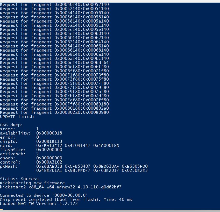

2 years 6 months ago
successful machine with a Windows Bootable and by modifying the last pack that you made I managed to update it to version 1.5.39
- jumpy76

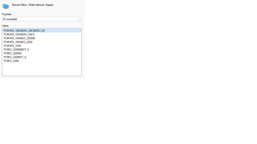

Can you please help me?
I need to update the Marvell firmware of my MSI Z790 Godlike Max, I have a lot of package loss.
I tried the firmware updater, but my card isn't recognized.
- Posts: 189
It could be the same problem admin had give me your hardware id and i will check for you
otherwise you would have to add support in for it in the ini
but there are many different config's for different cards
i wouldnt go trying random stuff unless you have a backup of your firmware
dumped by desoldering the flash chip for the aqc113c
as there's a chance it will get bricked see my previous posts what i had to go through to unbrick a card

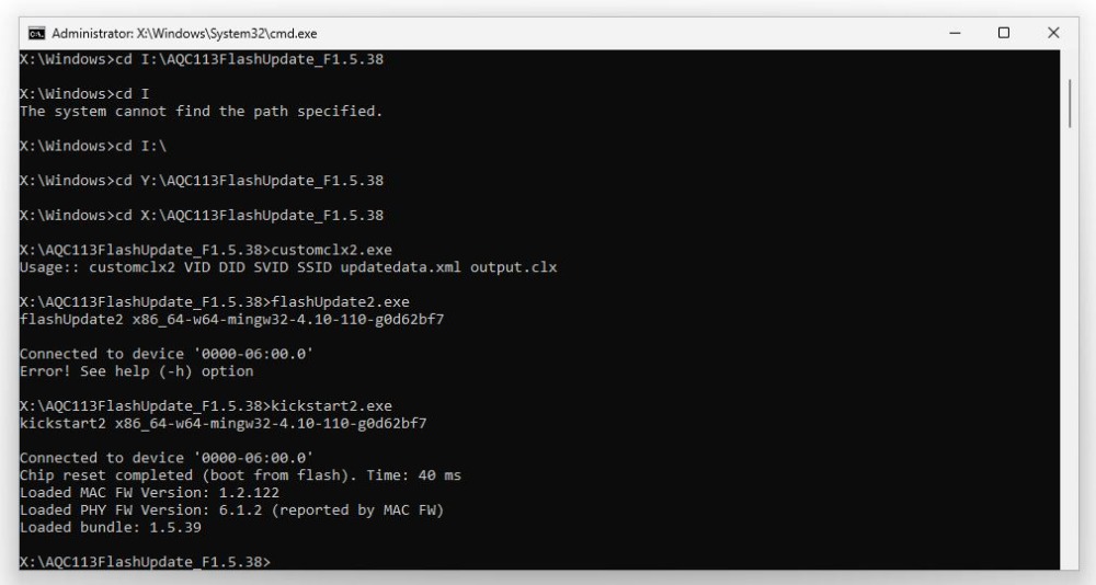

For me I succeeded by recovering the config file from version 1.3.38 then modifying the versions from 38 to 39 then creating a key with Windows with HBCD
Créer une clé USB bootable de Hiren Boot CD PE - Live CD - Tutoriels - InformatiWeb
Thank you for your answer. This is my hardware ID. I read Antigua in some of the descriptions.
