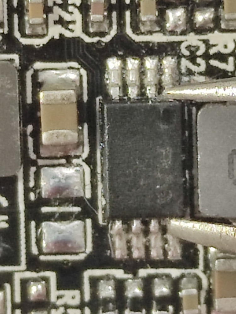

last attempt made with the electrician's tweezers and the smartphone as a microscope, still no result.
The rom is a Puya P25D40H

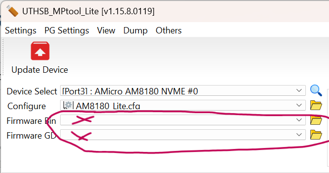

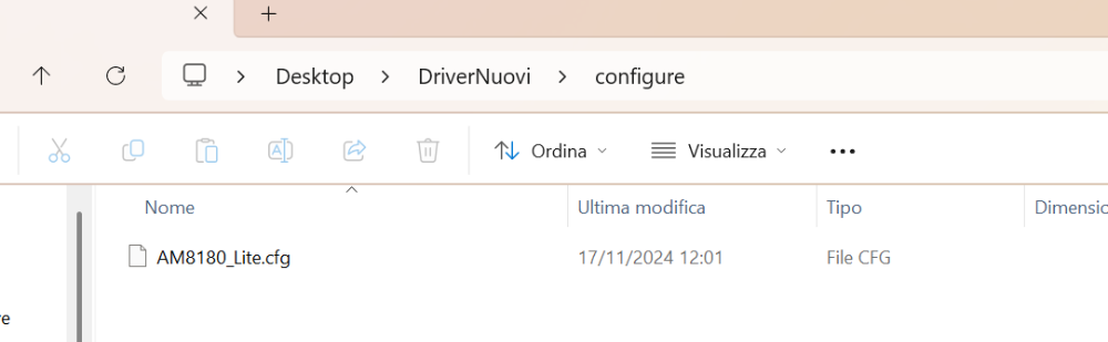

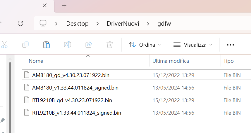

Ok thank you very much.
Now when I select that config file that you uploaded, the uthsb tool lite doesn't select the firmware bin and GD. I'm trying to flash the latest v1.33.44 driver, but it doesn't select the files when I try to flash to the Lemorele AM8180 enclosure. I've tried renaming the firmwares with "AM8180" but no luck. How should I modifiy the bin files so that I can select them?
