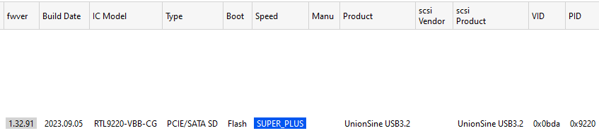

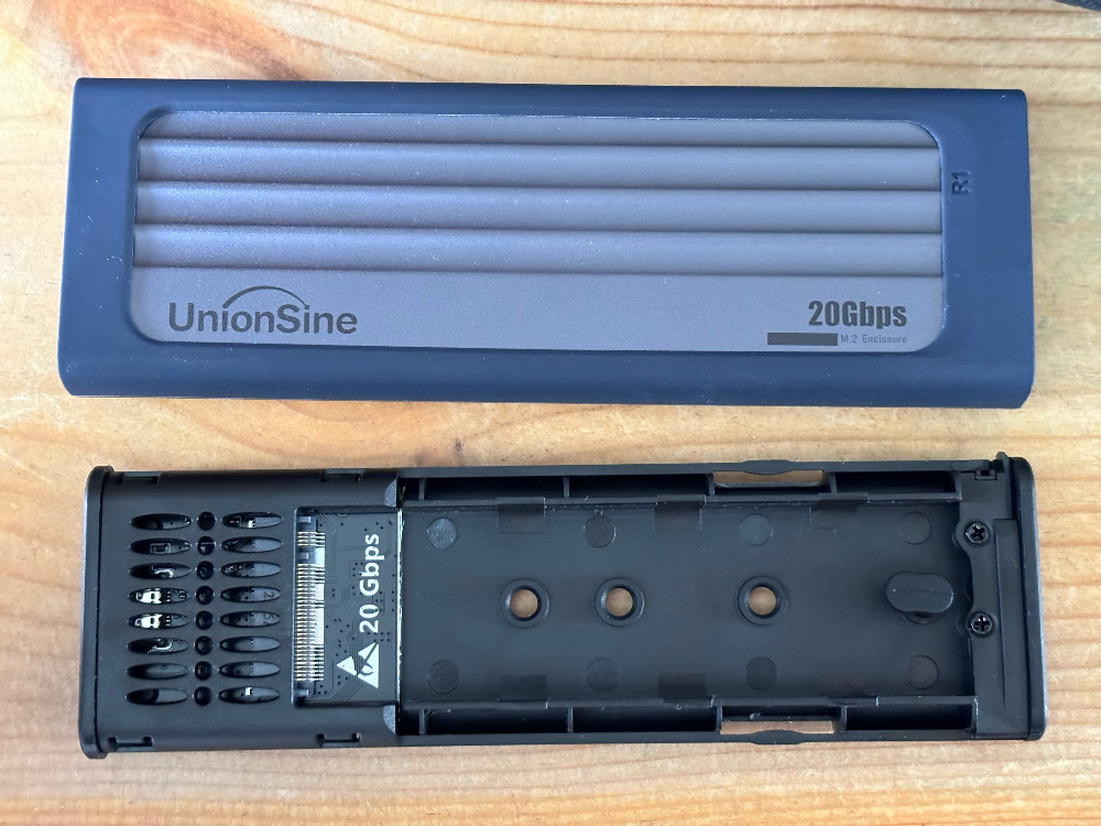

I recently got a UnionSine NVME Enclosure, it's supposed to support USB 3.2 Gen 2x2 20Gbps (though I have no way of verifying this, as my PC supports a maximum of 10Gbps).
Warning: Spoiler!
Which Unionsine enclosure do you have,they sell 2 that look almost the same and the other is called Hiksemi and people get them mixed up,I own both that way I have 2 different looking enclosure's because I need a lot of portable storage space.
This one , the 20 Gbps option - it seems quite nice outside of the weird speed issue on Linux and is completely toolless, it doesn't mention in the description at all, but it came with a (manual says graphene, though I'm not sure it is) thermal pad too.

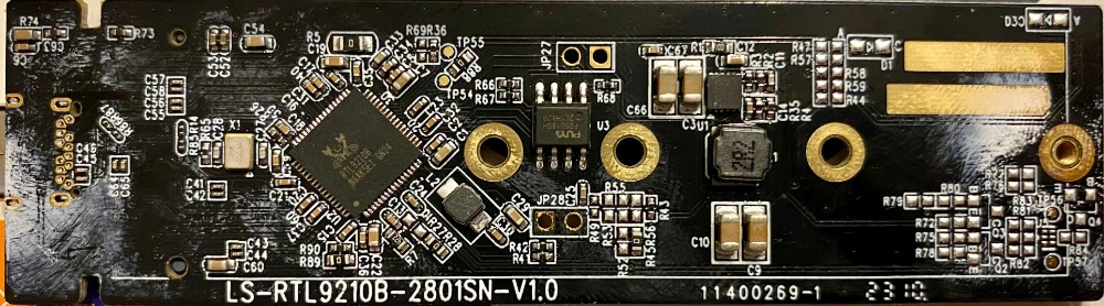

I realised the board was just held in with clips and easy to take out/put back in, so here's a picture of the side of the board with the Realtek chip too for anyone interested:
A few of the packages here had the firmware GD file for RTL9220 chips, but I've not been able to find any actual firmware bin files available for it.

Maybe someone will be interested – Qoltec NV2270 Model: 52270M.2 STAT/NVMe enclosure
*NOTE: This white paste all around PCB isn’t just this exact unit issue, but local distributor confirmed that everything what they have on their warehouse looks like this.
Anyway, the most interesting is firmware:
FW Ver : 9.29.33
FW Build Date : 2022.04.21
All firmware available here are starting from 1.xx.xx, so I’m wondering how different is this 9.xx.xx one? Could be safely updated with 1.33.44.011824?
