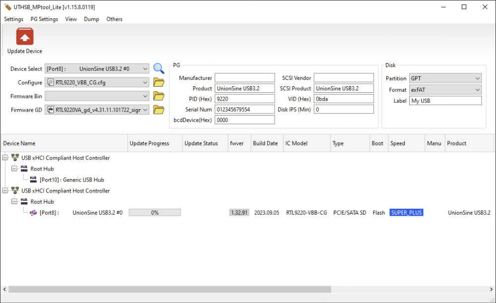

2 years 6 months ago - 2 years 6 months agoThis one , the 20 Gbps option - it seems quite nice outside of the weird speed issue on Linux and is completely toolless, it doesn't mention in the description at all, but it came with a (manual says graphene, though I'm not sure it is) thermal pad too.Which Unionsine enclosure do you have,they sell 2 that look almost the same and the other is called Hiksemi and people get them mixed up,I own both that way I have 2 different looking enclosure's because I need a lot of portable storage space.I recently got a UnionSine NVME Enclosure, it's supposed to support USB 3.2 Gen 2x2 20Gbps (though I have no way of verifying this, as my PC supports a maximum of 10Gbps).
Warning: Spoiler!**************************************************************
Device : [Port8] : UnionSine USB3.2 #0
U2PHY : n/a
U3PHY : n/a
PID : 0x9220
MANUFACTURE : " "
PRODUCT : "UnionSine USB3.2"
SERIAL : "012345679554"
SCSI_PRODUCT : "UnionSine USB3.2"
SCSI_VENDOR : " "
USB_SELF_PWR : n/a
DISK_HOTPLUG : n/a
LED : 0x03
PINMUX1 : n/a
PINMUX2 : n/a
U2_MAXPWR : n/a
U3_MAXPWR : n/a
ASPMDIS : n/a
DISK_IPS_THRES : n/a
UART_DBG_PIN : 0x64
HW_LED_CFG : 0x00000000
PERIPH_API : n/a
RAID_CFG : n/a
FW Ver : 1.32.91
FW Build Date : 2023.09.05
IC Pkg Type : PCIE/SATA SD

A few of the packages here had the firmware GD file for RTL9220 chips, but I've not been able to find any actual firmware bin files available for it.

The firmware should be upgradable, it's detected fine in MPtool Lite and after I made a config that shows fine and it automatically selected the Firmware GD file from one of the firmware packs I downloaded here, problem is I've not found the actual Firmware Bin for updating it available anywhere so far (as you'll see from the screenshot, the firmware already on it is newer than any available here)

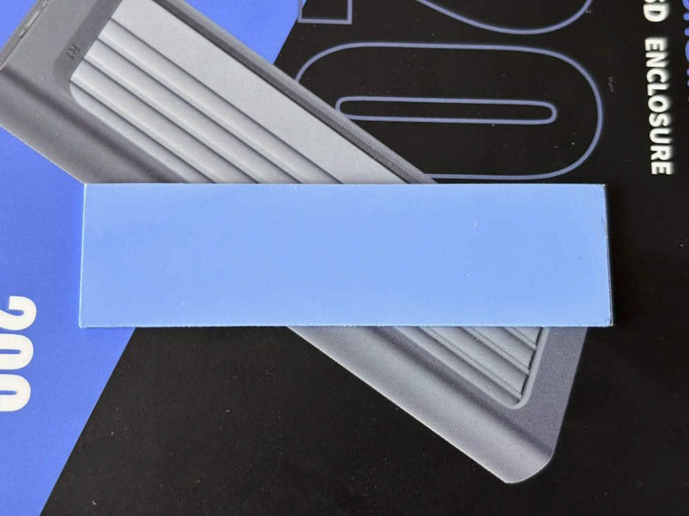

This is the thermal pad, I've not actually used it as my drive has been cool enough anyway for it not to be required - I can't see any issues with you replacing it if you want to:
