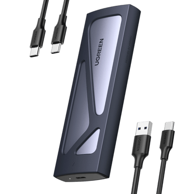

Recently I bought this Ugreen NVME M2 USB adapter, model CM578.
Oryginal dump:
I successfully updated RTL9210 firmware to 1.32.87.082923 but I still have problem with this enclosure.
When I connect it to my PC to USB 3.2 gen 2 I get max 425MB/s parrel read. I tried with USB A and USB C cable from enclosure set. I don't have other cables or PC to test it more.
On Raspberry Pi 5 I've got worse problems. Before update enclosure was disconnecting during heavy IO operations from docker containers. Synthethic fio doesn't cause problems. After update things are even wores. Even disk is idle, enclosure keeps disconnecting and connecting. I've tried active hubs, connecting to USB 2.0 with no success.

Hi,
The throughput problem may be due to poor management of the SSD by the RTL9210 controller, try the latest firmware for the SSD if available and if the problem persists, try with another USB 3.2 cable
