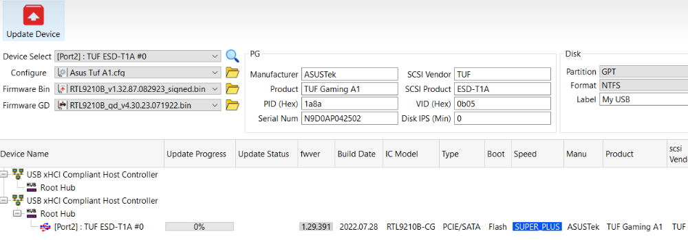

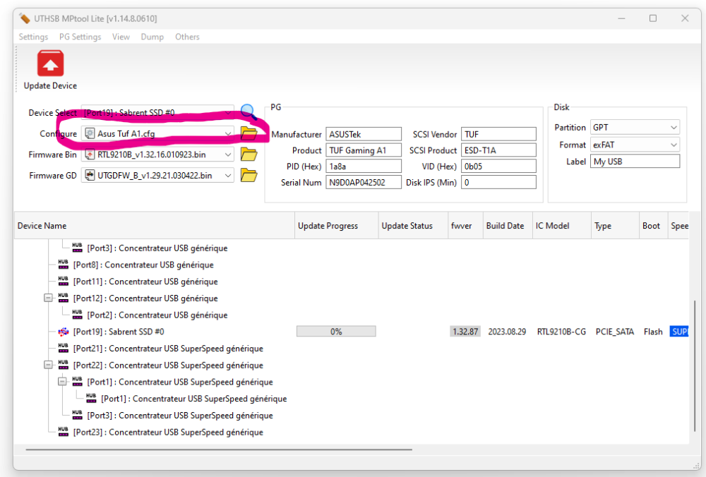

Ok take the firmware pack then the configuration file and select it in the update utility as below
Firmware Realtek RTL9210
Fils Config Asus A1
Fils Config Asus A1
