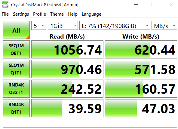

Hello
I just bought the asus tuf gaming a1, and I heard all that use realtek 9210b chipset should update it firmware, I search online and the tools seem to be from here.
I don't want to broke my tuf a1 so here I ask, how to update fw without breaking it. I read that if there is problem with the update, with dump info then I would know what the original parameter are, but how to revert the update with that dump info I save before perform an update?
If any one here can provide me step about what to do and answer me how to prevent it from brick that would be a lot of help (I read here there a bridge 1 and 8 pin to reset? but I'm not confidence enough to do that)

the reason I want to update my tuf a1 is because the writing speed, reading speed is as what the spec was, but the writing speed is not.

Hi, you can update it without any problem, you just need to retrieve the configuration file to use it for the update
www.station-drivers.com/index.php/en/les...t-asus-tuf-gaming-a1
