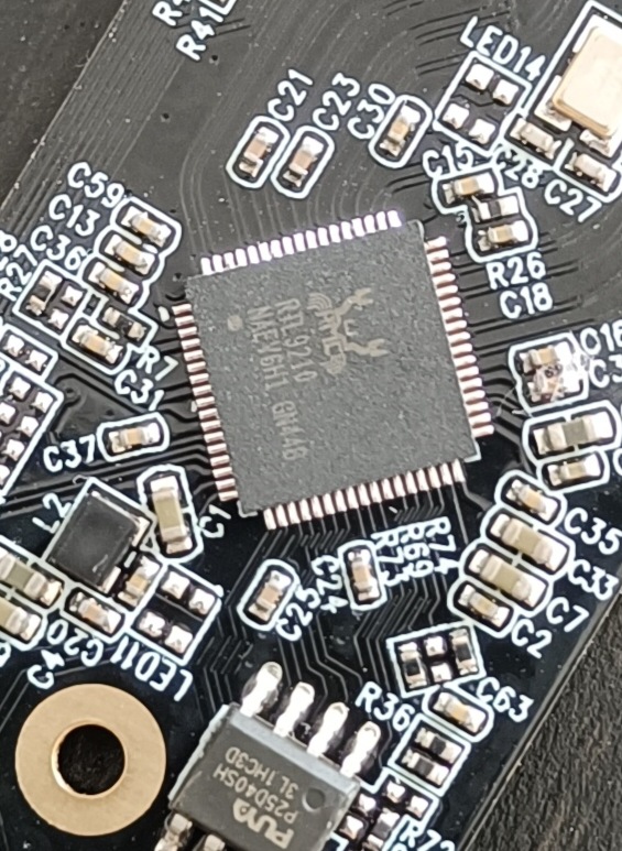

I bought a cheap noname USB enclosure from Aliexpress with RTL9210. They marketed it as dual-protocol, compatible with both NVMe and SATA drives. I want to use it with M.2 SATA drive from old laptop (Hynix SC311), but the drive isn't detected there at all. I tried to put a NVMe drive into the enclosure and it worked, but I want to use it with the SATA drive. Is there any way how to get it working, or RTL9210 works only for NVMe drives?
BTW, original firmware was 1.32.7, tried updating it to 1.33.7, but no change.
