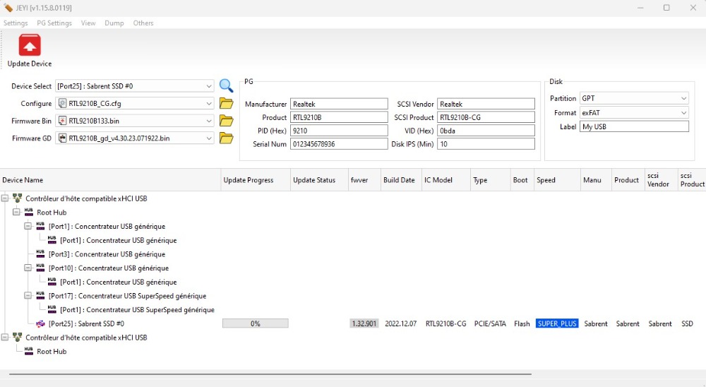

I'm having a strange problem with these enclosures that I have never had with any enclosure before,they use an RTL9210 controller.
[url] www.aliexpress.com/item/1005004963769541...n.317.5d431802r7vavP [/url]
The problem I'm having is after I flashed one enclosure with firmware v1.32.90 and was successful with updated one enclosures firmware the next one failed no matter how many times I tried and no matter what firmware I used.
I looked at the dump file for each enclosure only to find one thing different and that was the serial numbers,the enclosure that flashed and updated fine serial number is 012345678914 and the one that failed was 012345678915.
The 4 at the end of the serial number changed to a 5 and for some reason it also changed the serial number on the configure file on it's own,I use configure file RTL9210_Lite_10.cfg for both enclosures.
I was able to get the enclosure that failed to flash to update successfully but only after I changed the last digit in the serial number from a 5 to a 4,I should also note that it also has changed from 4 to 6 after I tried flashing it different times to see what was going on with it.
