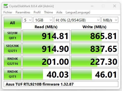

Here but performance with AN RTL9210 on my Asus TUF

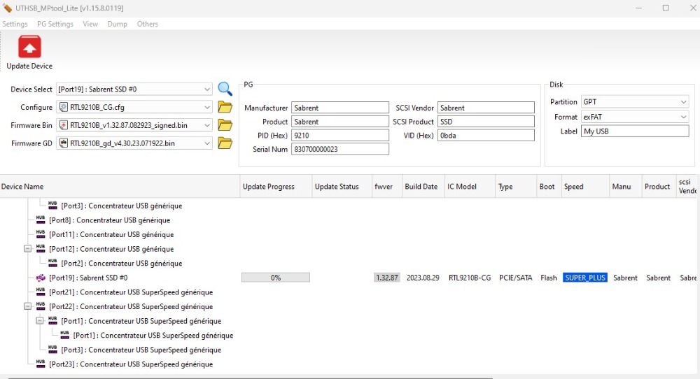

The attached image is the stock firmware and settings from the update tool. I also have now saved the configuration.

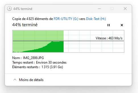

I noticed that you are using multiple files present. What happens if you try and transfer a single 40+ gb file on your drive? Does it slow down?
