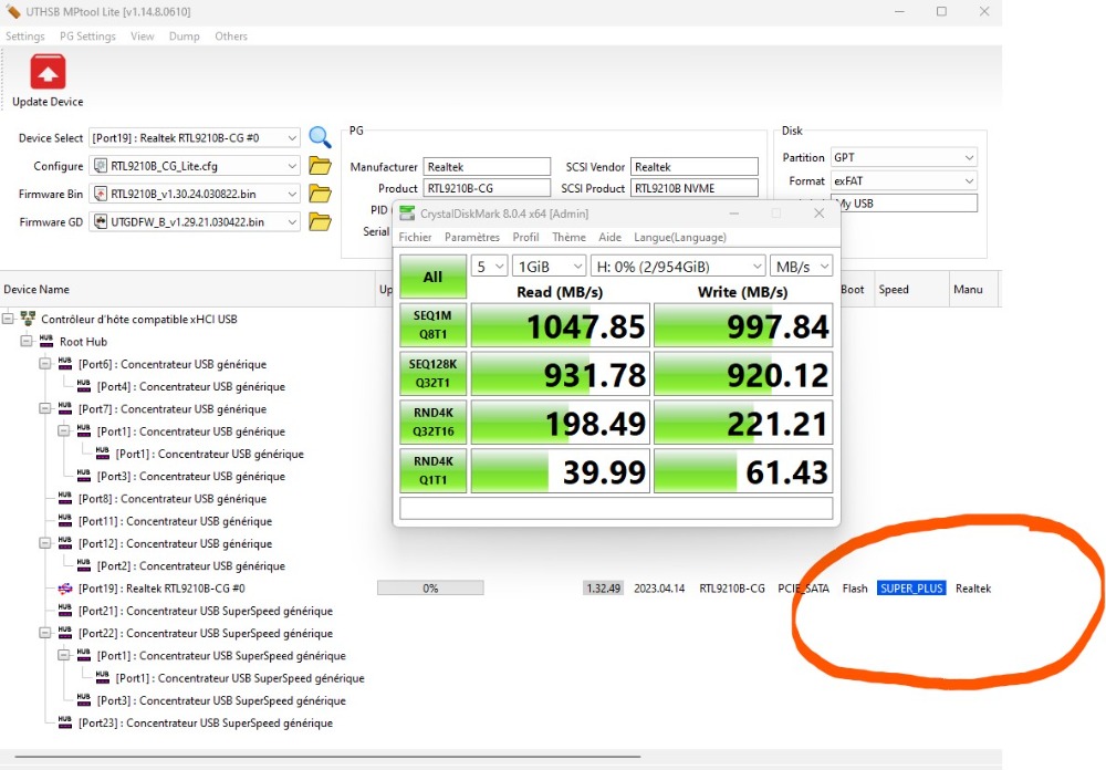

Hi @spike_V_sky as I mentioned on the first line, issues were solved.
I had to flash the FW twice for it to work. Then I reconnected the enclosure, formatted the disk, and I guess I proceeded with my tests.
Then wrote this post after being really disappointed.
I disassembled the enclosure, removed SSD, put it together again and after connecting it, I managed to get 375 MB/s. Idk if others reach higher speeds than me, but for me this is more than enough.
Thank you for taking your time to answer!

Hi @admin,
yes, it only says SUPER.
According to MSI's specs, my Type C port is: USB3.2 Gen1
If I got it correctly, it should only support 5gbps, right?
Isn't 375 MB/s fast enough?
Please know that my laptop's SSDs might be throttling my newer external SSD.

Hi @wade7575, @all
I think I will not get much of a difference by changing FW versions. I got the latest version installed already, and as I mentioned, I got real work copy speed of 375 MB/s over a 12 GB file.
And I also have a USB 3.2 Gen 1 port.
See also Crystal Mark below.
Thank you very much for your time
