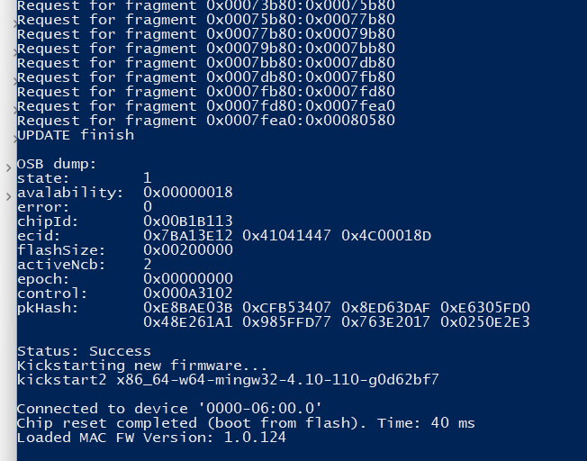

Getting four part IDs... Read four part IDs from the device: 0x1D6A (VID), 0x14C0 (DID), 0x1D6A (SVID), 0x0001 (SDID) Deleting the existing updated.clx file... Updating the clx file... ./customclx2 0x1D6A 0x14C0 0x1D6A 0x0001 updatedata.xml updated.clx exprom        :1 Image Name    :AQC113-Antigua_Bx-1.3.36_bdp_aqsign.clx macBdpLen     :32 phyBdpLen     :28 Custom clx generated  updated.clx Flashing the device with updated.clx... flashUpdate2 x86_64-w64-mingw32-4.10-110-g0d62bf7 Connected to device '0000-05:00.0' Starting hostboot (requested by user)... Chip reset completed (boot from host). Time: 400 ms Success load UpdateAgent UPDATE start Request for fragment 0x00000000:0x00001800 Request for fragment 0x00003000:0x00005000 Request for fragment 0x00005000:0x00007000 Request for fragment 0x00007000:0x00009000 Request for fragment 0x00009000:0x0000b000 Request for fragment 0x0000b000:0x0000d000 Request for fragment 0x0000d000:0x0000f000 Request for fragment 0x0000f000:0x00011000 Request for fragment 0x00011000:0x00013000 Request for fragment 0x00013000:0x00015000 Request for fragment 0x00015000:0x00017000 Request for fragment 0x00017000:0x00019000 Request for fragment 0x00019000:0x0001b000 Request for fragment 0x0001b000:0x0001d000 Request for fragment 0x0001d000:0x0001f000 Request for fragment 0x0001f000:0x00021000 Request for fragment 0x00021000:0x00021d10 Request for fragment 0x00021d40:0x00023d40 Request for fragment 0x00023d40:0x00025d40 Request for fragment 0x00025d40:0x00027d40 Request for fragment 0x00027d40:0x00029d40 Request for fragment 0x00029d40:0x0002bd40 Request for fragment 0x0002bd40:0x0002dd40 Request for fragment 0x0002dd40:0x0002fd40 Request for fragment 0x0002fd40:0x00031d40 Request for fragment 0x00031d40:0x00033d40 Request for fragment 0x00033d40:0x00035d40 Request for fragment 0x00035d40:0x00037d40 Request for fragment 0x00037d40:0x00039d40 Request for fragment 0x00039d40:0x0003bd40 Request for fragment 0x0003bd40:0x0003dd40 Request for fragment 0x0003dd40:0x0003fd40 Request for fragment 0x0003fd40:0x00041d40 Request for fragment 0x00041d40:0x00043d40 Request for fragment 0x00043d40:0x00045d40 Request for fragment 0x00045d40:0x00047d40 Request for fragment 0x00047d40:0x00049d40 Request for fragment 0x00049d40:0x0004bd40 Request for fragment 0x0004bd40:0x0004dd40 Request for fragment 0x0004dd40:0x0004fd40 Request for fragment 0x0004fd40:0x00051d40 Request for fragment 0x00051d40:0x00053d40 Request for fragment 0x00053d40:0x00055d40 Request for fragment 0x00055d40:0x00057d40 Request for fragment 0x00057d40:0x00059d40 Request for fragment 0x00059d40:0x0005bd40 Request for fragment 0x0005bd40:0x0005dd40 Request for fragment 0x0005dd40:0x0005fd40 Request for fragment 0x0005fd40:0x00061d40 Request for fragment 0x00061d40:0x00063d40 Request for fragment 0x00063d40:0x00065d40 Request for fragment 0x00065d40:0x00067d40 Request for fragment 0x00067d40:0x00069d40 Request for fragment 0x00069d40:0x0006bd40 Request for fragment 0x0006bd40:0x0006db64 Request for fragment 0x0006db80:0x0006fb80 Request for fragment 0x0006fb80:0x00071b80 Request for fragment 0x00071b80:0x00073b80 Request for fragment 0x00073b80:0x00075b80 Request for fragment 0x00075b80:0x00077b80 Request for fragment 0x00077b80:0x00079b80 Request for fragment 0x00079b80:0x0007bb80 Request for fragment 0x0007bb80:0x0007db80 Request for fragment 0x0007db80:0x0007fb80 Request for fragment 0x0007fb80:0x0007fd80 Request for fragment 0x0007fd80:0x0007fea0 Request for fragment 0x0007fea0:0x00080580 UPDATE finish OSB dump: state:        1 avalability:  0x00000078 error:        0 chipId:       0x00B1A113 ecid:         0x6BA10D38 0x61141553 0x48000168 flashSize:    0x00200000 activeNcb:    1 epoch:        0x00000000 control:      0x00020000 pkHash:       0x00000000 0x00000000 0x00000000 0x00000000               0x00000000 0x00000000 0x00000000 0x00000000 Status: Success Kickstarting new firmware... kickstart2 x86_64-w64-mingw32-4.10-110-g0d62bf7 Connected to device '0000-05:00.0' Error: MAC firmware is not started. Reset status = 0x15000000 PS D:\1>

i can now flash it with
./flashupdate2 --reflash ATL2-8.0.1_AGENT_sign.CLX updated.clx
./kickstart2
Loaded bundle: 1.3.36
