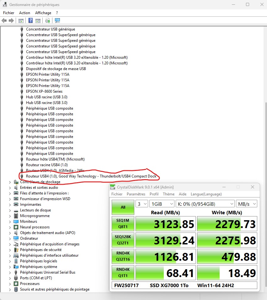

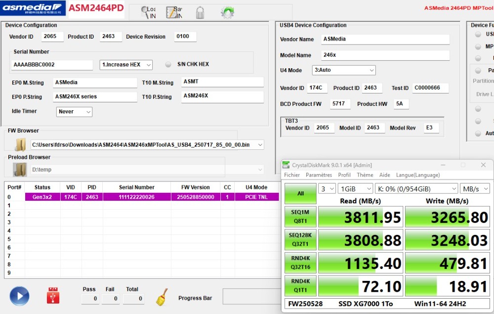

External Thunderbolt 4 USB-C enclosure on USB-C Thunderbolt 4 DOCK output of the Gigabyte Z890 Master motherboard
