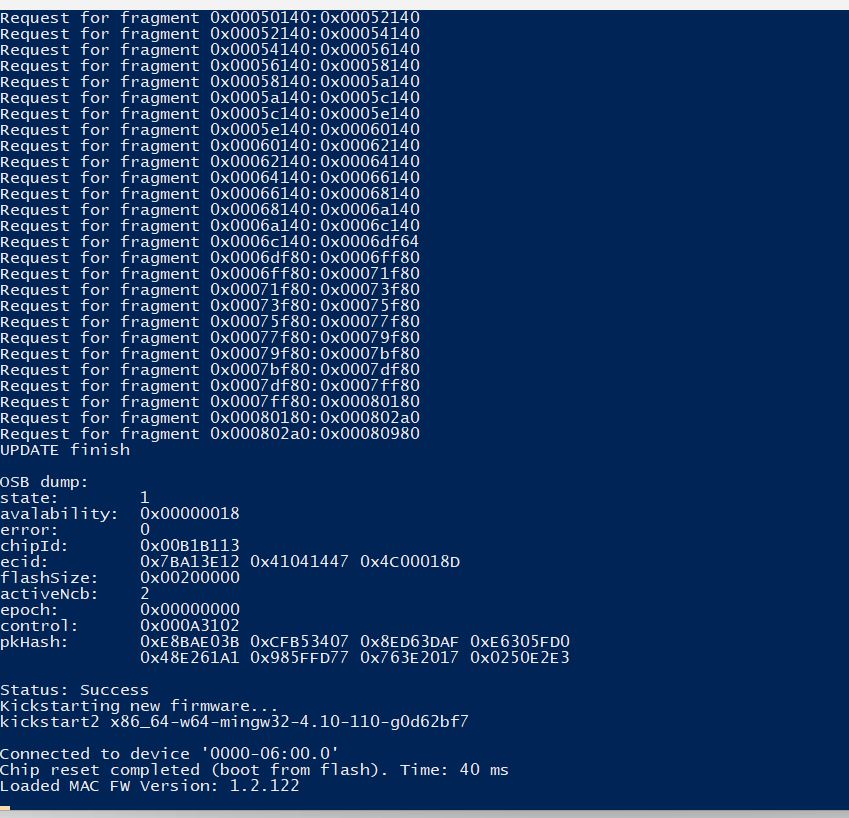

2 years 4 months ago
successful machine with a Windows Bootable and by modifying the last pack that you made I managed to update it to version 1.5.39
- jumpy76

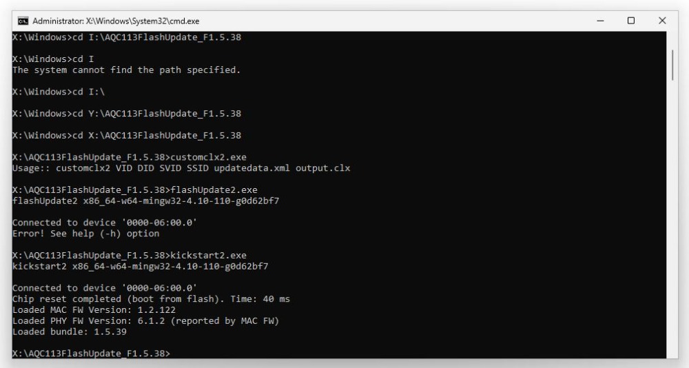

For me I succeeded by recovering the config file from version 1.3.38 then modifying the versions from 38 to 39 then creating a key with Windows with HBCD

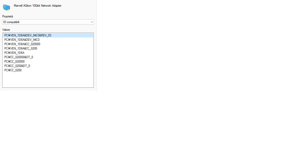

Thank you for your answer. This is my hardware ID. I read Antigua in some of the descriptions.
