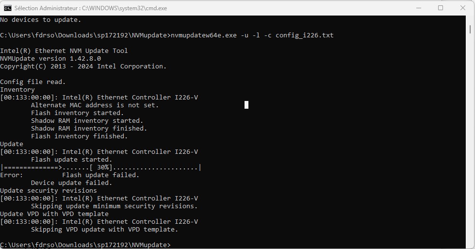

Intel(R) Ethernet NVM Update Tool
NVMUpdate version 1.42.8.0
Copyright(C) 2013 - 2024 Intel Corporation.
nvmupdatew64e.exe -i -l inventory.txt
Config file will not be read.
Inventory
[00:133:00:00]: Intel(R) Ethernet Controller I226-V
    Alternate MAC address is not set.
    Flash inventory started.
    Shadow RAM inventory started.
    Shadow RAM inventory finished.
    Flash inventory finished.
    Vendor                 : 8086
    Device                 : 125C
    Subvendor              : 1043
    Subdevice              : 8867
    Revision               : 6
    LAN MAC                : xxxxxxxxxxx
    Alt MAC                : 000000000000
    SAN MAC                : 000000000000
    ETrackId               : 8000039D
    SerialNumber           : A0AD9FFFFFA10858
    NVM Version
 : 2.35(2.23)
    PBA                    : G23456-000
    VPD status             : Not set
    VPD size               : 0
    NVM update             : No config file entry
      checksum             : Valid
My NVM firmware cannot be updated, probably due to my newer version.
For those interested, you just need to modify the "config_i226.txt" file with your chipset ID codes and then run the command "nvmupdatew64e.exe -u -l -c config_i226.txt" in CMD.
