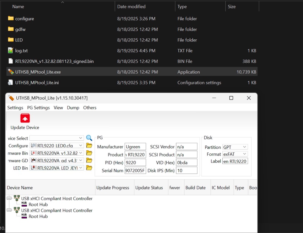

because the LED bin file is too old (from 2023), Although it has been configured the same as the original dump file, but the LED did not work as originally enclosure version; therefore we need to update LED bin file.
I sent email to Ugreen support, hope they can ship suitable firmware.

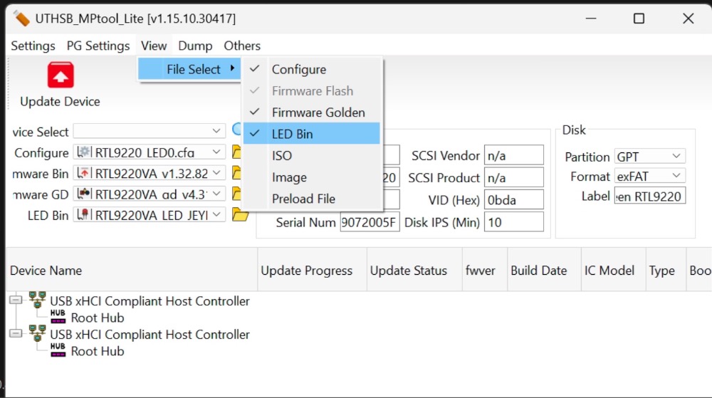

1 year 3 weeks ago
It shipped with 1.32.82 version, but too old. You can try it.
1. Download firmware version as link below
2. Select View/Led bin
3. update firmware
www.station-drivers.com/index.php/en/com...2.081123/lang,en-gb/
