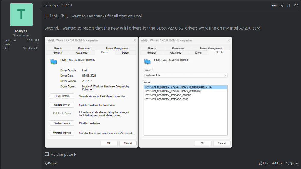

3 years 1 month agoIt's not as easy as opening the INF file as that takes time since one needs to know their device ID's to know what the actual device names are which is time consuming. 23.0.5.7 description was updated that it supports BExxx only but apparently someone with a AX200 has it working which isn't even a mentioned supported device as seen here www.elevenforum.com/t/drivers-intel-ethe...th.11383/post-350536 .You can open the INF in simple notepad like I did as you can see in the attached screenshot in my earlier postI have no way to test it regardless what the INF says, I still need to learn how to read INFs but usually MoKiChU knows what devices are supported since I am sure he checked the INFs first or else he would have said it supported everything else too before he even posted it originally. Is there a tool somewhere that can extract the Device ID's and such from the INFs as I am sure no one is going to go read each INF slowly and then copy and paste the lines so there must be some way you and others are doing it.This package ain;t compatible with AX211Intel PROSet Wireless WiFi Drivers v23.0.5.7 WHQL with many thanks to MoKiChU

How do you forcefeed the INF as I tried and it said I already had the latest drivers when I browse to the main folder and let it install.

@Almighty1
If you want to get a specific driver installed, whose INF file natively doesn't support the related device, you may be successful by forcing the installation.
You have to use the "Let me pick..." option, press the "Have Disk" button and then navigate to the best matching INF file. You will have to disregard the upcoming warning.
