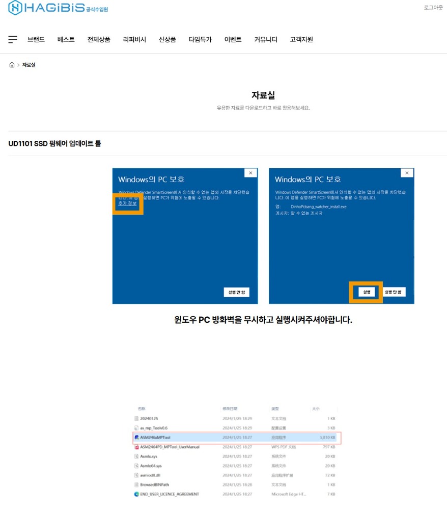

i mainly wanted it as i have been trying to get firmware out of hagibis for around a year its like pulling teeth
i will watch the korea website super annoying that i had to make a naver account to download though
btw feel free to delete all of my messages in this thread if you want to declutter it
BTW I was reading through support requests on hagibis korea and he was talking about his firmware was 230525850202
AS_USB4_230525_85_02_02.bin
AS_USB4_231005_85_02_03.bin
AS_USB4_240417_85_02_04.bin (My First unit dont have a backup)
so the last digits seem to be the release number of the 02 build

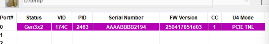

I bought QWIIZLAB Fanless USB4.
This is the native twin of the HAGiBiS MC40.
It also has a two-color connection speed indicator.
Came with firmware 250417_85_1D(29)_03
