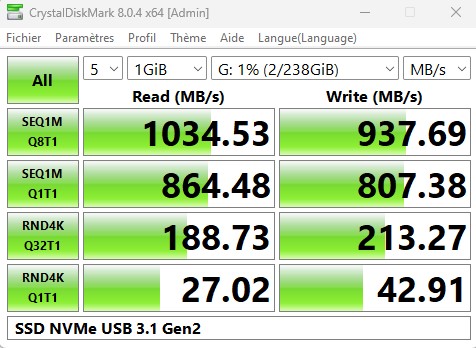

I redid a test with crystaldisk and I gained in speed with the new firmware 2.1.2.0
