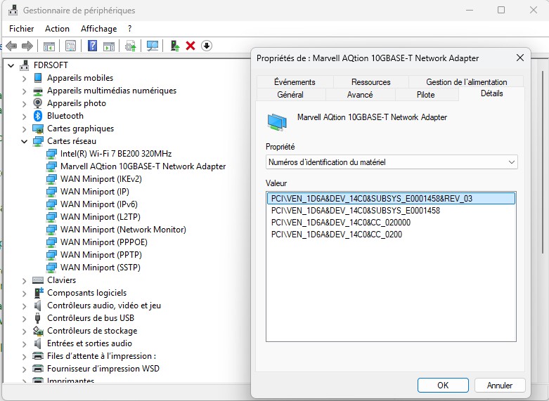

Thank you, but it still doesn't work. The adapter is recognizer (a little older driver, but it from Marvell), running from HDD and not USB key as administrator, no difference.
Perhaps the ID is not recognized.
Could you take a screenshot and post it here?
It's possible the ID isn't correct.
