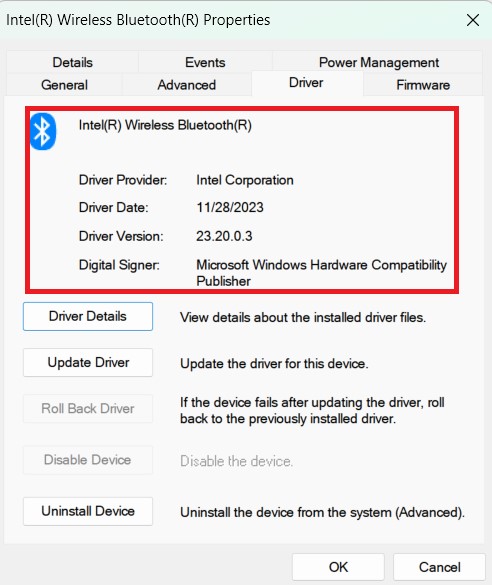

The problem must on your computer, I have this driver installed without problems.
It is maybe related to the Setup program, but if you use the device manager and update from there, it works.
I never use a Setup program.
Below the link to the driver set of Intel v23.20.0.3:
mega.nz/file/pI1FjCZJ#TFhw_D1JvAzLJCFnvR...oW2IwkDTZ-3Cw_omfeZc
Use the device manager, if you still get an error message, post a sceenshot.
This is my screenshot that it works:
